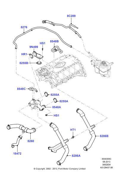

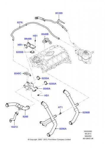

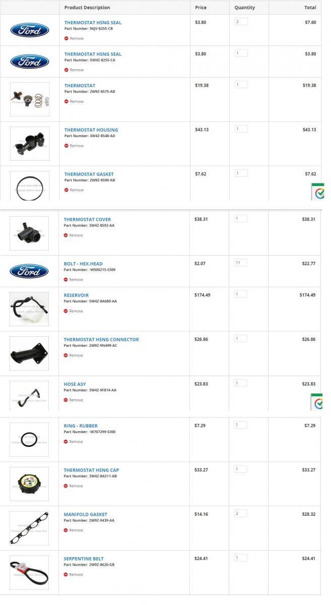

I have read prior post in reference to other who have had similar issues and there was a suggestion of replacing all plastic parts in the cooling system because of pockets of air preventing circulation through micro-cracks in the plastic. Just as a reference about how much would a job like that estimate on cost????
DIY: about $500, more if you need the radiator too (you almost certainly do, overheating shocks the radiator too).
This is why we keep saying to do it all when the first part fails...
so when you say you are replacing every year...
do you mean that you are replacing EVERY plastic cooling part every year? or do you mean that you are having to replace something every year cause it starts to overheat again and that you have (almost) replaced every cooling part?
