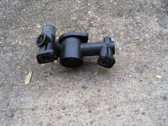

Joe... wheres the pics :D

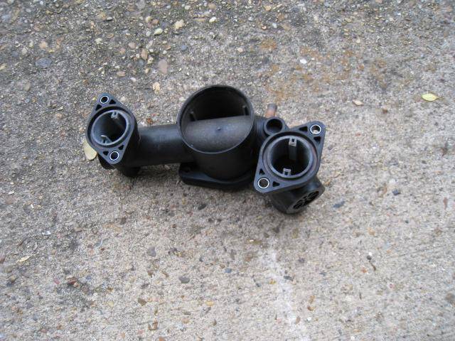

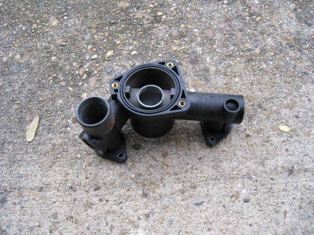

Here's some of one of the parts that I hadn't thrown out yet.
Thats the one that is currently leaking on mine. Thats the one that goes right nest to/under the throttle body right?
Yes, just under and nest (I mean next) to the throttle body.
Yup, thats the one. Hard to take off? I was looking at it the other day and it seemed like the bottom bolts would be tricky to get to
I didn't really have any trouble with them. I had to take one of the throttle body heater hoses off to get to one of the bolts.
