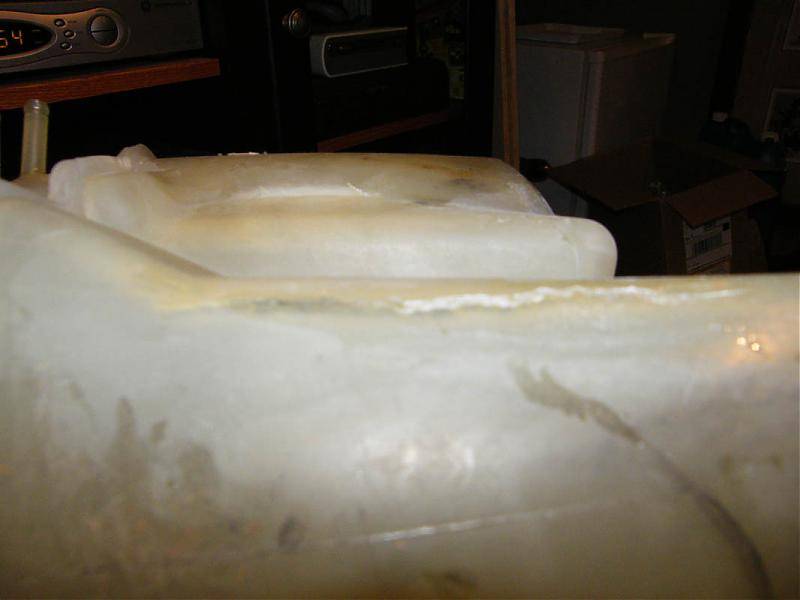

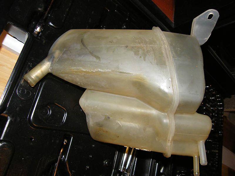

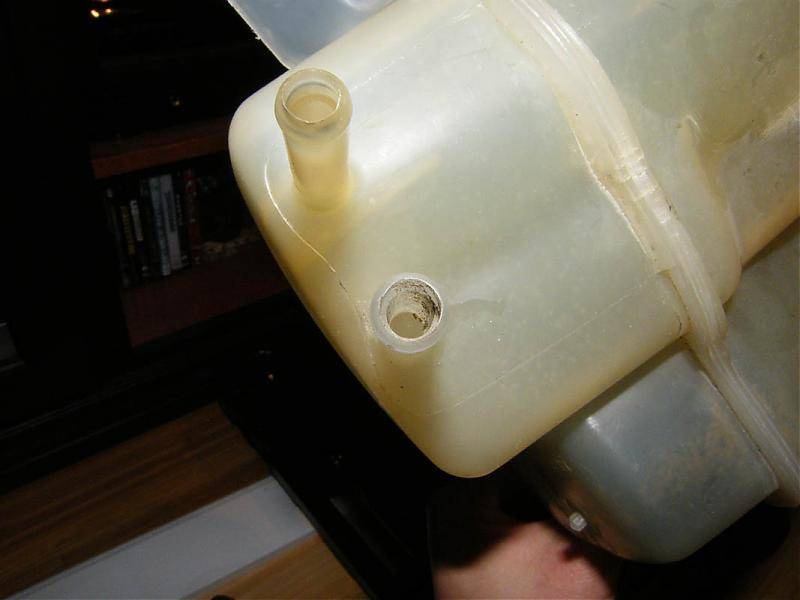

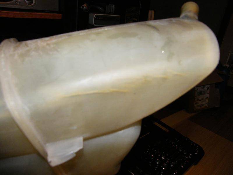

Here are some pics of what you can't see until the tank is removed. The cracks are difficult to see with the camera, but they are there. This is what is causing my leaks and letting air into the system. The last picture shows the metal tube, or at least where it should be. Mine had fallen inside the tank!
I'm hoping this alone fixes my leak and poor heat at idle, and that my aux pump is fine.

i took the wheel off, and right above where the fuel filter goes, theres like a little triangle cut out to get to the bottom hose clamp, i just expanded the triangle hole to get my wrench in there, also my degas bottle looked exactly like yours with the crack, everyones does, its unbelievable!
