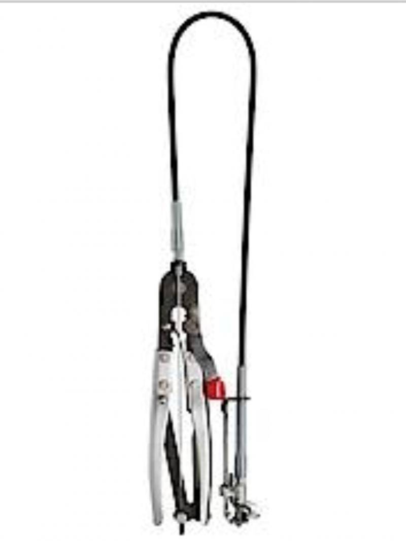

I used these hose clamp pliers. I couldn't get my monkey hands and any kind of pliers into the tiny little space.
That is very similar to the NAPA tool I bought. However, I did not use them for the degas bottle hose since I previously used a Channel lock.
But I have tried to use this tool on the main radiator hose and one of the small ones near the throttle body. Problem I had at least for the main hose was that there wasn't enough clamping range to fully remove the main hose clamp, and the little TB hose was too small to allow the tool to work. The NAPA bent nose pliers worked fine(I now keep them in my car), actually any pliers would have worked there. Still trying to get a success with the special tool, but my habit when I remove sping hose clamps is to chuck them as far away from me as I can and then put in a worm gear clamp. So I never have a second opportunity to try the special tool on that hose.
Yes, I use right angle pliers on the small hose clamps, but the hose clamp pliers tool that I have is big enough to work on the large radiator hoses. (It works on the mid-size ones too, just not the smallest hoses.) I'm the opposite on the clamps. I throw out the worm gear clamps and replace them with the spring ones. I don't mind the worm gear ones on hoses that go over metal, but I definitely want the spring type on hoses that go over plastic.
The pliers pictured above are from advance auto parts. They have an opening reach of like 4-5 inches and clamp down all the way. So they get all the clamps big to tiny. They work well. They were $25 iirc. But I always use coupon codes so I think they were $17 after 30% off.
The one from NAPA does have enough open reach but doesn't seem to ratchet down enough to remove the big hose clamp.
Also seems like the clamp end of the NAPA tool is a bit wobbly so it falls off if you have to clamp down a lot. So I guess the flexible NAPA hose clamp tool would not be my recommendation. Probably the other brands you guys mentioned are the choice here.
I bought the NAPA tool because it was a pita to get at the degas water bottle hose clamp, but after the fact. All the other clamps on my car including the degas are reachable with channel locks and the bent nose pliers so I guess the flexible tool is a waste for me.
