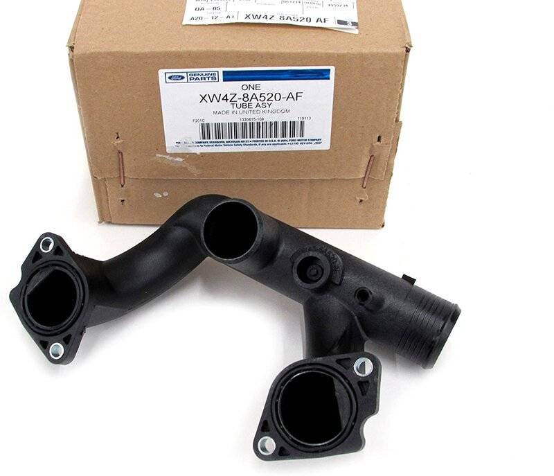

I had to open my system up as well to replace one of the plastic parts. The funny part is the part I ended up having to change was not bad only problem ended up being was that one of the bolts was loose. And now after opening the system I have the air bubbles (I kinda figured something stupid was the cause as the whole coolant system was replaced in the last 2 years). After working on that car most of this day I have decided to have it professionally done come Monday if the dang thing does not burp out over the weekend. I think it's time to invest in that vacuum kit that can suck the air out of the system in the near future. Does anyone have any suggestions for a good one?
Edit: I finally got lucky and now have full heat on any setting that I try. I'm not seeing any bubbles and I now see a constant flow. Gonna repeat the process in the morning and I most likely am done. But I am still interested in what I said above to make the future coolant system maintenance easier.

What was going on with your cooling system Dale? Good to hear you got it bled properly...

I ended up replacing this because I thought it was cracked or something cause it was spraying coolant out but it turned out one of the screws was completely loose. I went ahead and changed it because the one I had was aftermarket and the new one I got was OEM so figured it was not a bad idea to change.
I think the reason I got lucky and it did not leak until now was because the last guy who changed that part for me used permatex around each side that screwed in.
I ended up replacing this because I thought it was cracked or something cause it was spraying coolant out but it turned out one of the screws was completely loose. I went ahead and changed it because the one I had was aftermarket and the new one I got was OEM so figured it was not a bad idea to change. View attachment 828574860
The O rings work fine for me without Permatex...I have a aftermarket on the LSE...Dayco brand ...paid $12.00 on Rockauto wholesale
