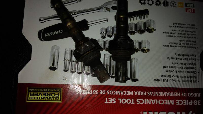

OK so, I didn't get to my vacuum leak today but I DID get my O2 sensors changed! What a PITA.

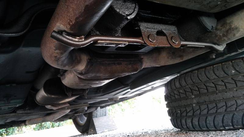

I don't know if the exhaust is suppose to be the way it was, or if it was altered by a previous owner but the passenger side was able to be dropped before the first cat by taking off two 15mm bolts. The driver side, however, detached AFTER the first cat, which was absolutely NO use to getting to the O2 sensor. We detached the first cat, detached behind the second cat, then detached the middle anchor and pulled the exhaust back a bit. Passenger side was cake. Driver side we messed with for a good hour before we spent another house squeezing our hands into a tiny space and trying to make JUST enough room to get the O2 puller socket on it and inch by inch break it loose and take it off. Reassembly was cake.

Old O2's were definitely bad and they were the FACTORY ones! Glad to get those changed out.

Ok so on the note of the exhaust. We were looking at it and were thinking about doing this. Right where the 3rd cat is located (right after the middle exhaust anchor...see picture) we were thinking about cutting there and pulling all the exhaust off from that point back. Then, we were considering going straight pipe from there back. Is that a logical idea or would I HAVE to put an Xpipe in place of the cat then straight pipe from there?

Go with at least one X pipe for pressure equalization. It will have more drone than having 2 of them but it depends on what you like. I never been a fan of straight piping a 4.6
