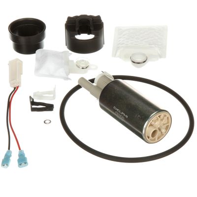

Quick question though. Here is a stock photo of a replacement pump w/ assembly:

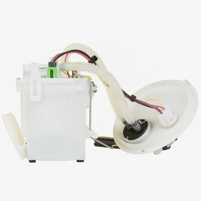

Here is an image of another product that Autozone also calls "fuel pump:"
Am I correct that the second photo is essentially the electric pump portion of the assembly shown in the first picture? As it appears that the problem is electrical (as opposed to, say, a clogged screen or something), I'm thinking I should be able to remove the assembly, replace just the electric pump component, and reinstall. That should work, no?
Yes, you are correct, but I think that the AutoZone pump is Airtex, and I think that is the one that was failing a lot.
Ebay (and other places too) has just the pump part for $30 to $50. One claims to be Motorcraft. I also saw Bosch and AC Delco. Those seem like safe brands...
Good points. Autozone has that pump part in stock for $120, with brand choices of Delphi or Spectra. The Airtex shows up on the Autozone website but is listed as unavailable.

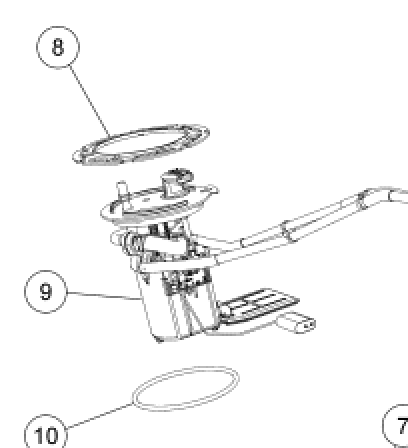

It looks like the fuel pump design is different between Gen I and Gen II. Here's a scaled, cropped diagram of the Gen II pump:

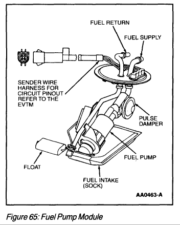

Here's the Gen I pump:
You can see that on the Gen II the crossover lines connect to the module under the "hat," and therefore inside the tank, whereas on the Gen I, the inlet and outlet tubes connect through the "hat," and therefore outside the tank.
So it looks like the task is indeed more involved on the Gen II. On the other hand, I've read on several threads on here that the Gen I fuel pump is or has been a common failure item, so maybe the redesign that included routing the crossover tubes inside the tank resulted in a more reliable pump that rarely needs replacing.
For the sake of completeness, here's the Gen I manual on replacing the pump. Incidentally, it doesn't say anything about replacing just the electric pump component, so I'm hoping it'll be evident how to do it just by looking at it.
