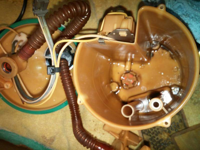

This one shows the inside of the canister. You can see the two filter screens, one inside the canister and the other outside. Also, note the little nut-driver bit next to the screwdriver. The screws that hold the lid on the canister have tiny hex heads and to remove and replace them, I just used the driver bit and my fingers (i.e. no driver handle).

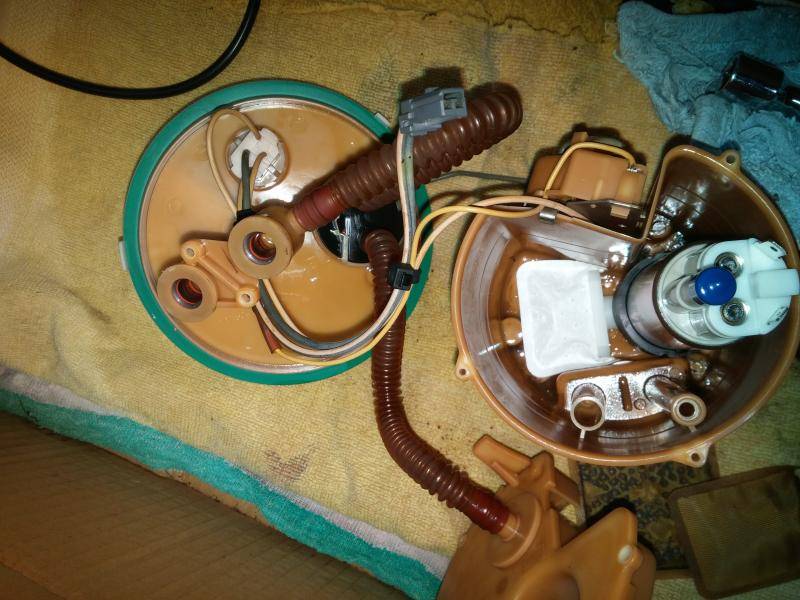

Here's the inside of the canister with the pump removed. (Once you get the lid off, the pump lifts right out.) You can see some brown sludge/residue on the bottom of the canister.

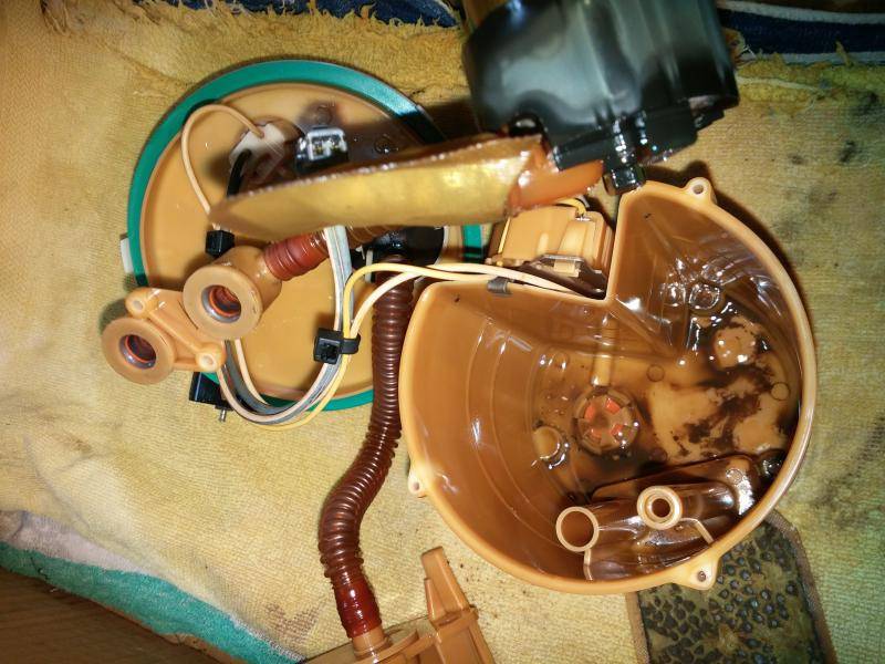

Here's a (blurry) shot of the inside of the canister after quickly wiping it out with a rag wrapped around a socket extension.

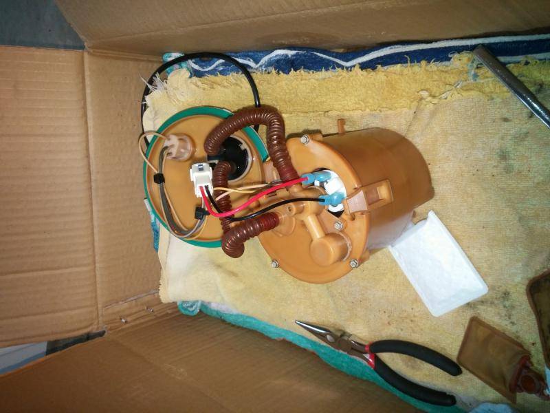

The new pump with new filter screen installed (i.e. placed) into the canister. Note that there is a rubber gasket that fits over top of the pump, which I had not yet installed when I took this pic. The blue protective cap is also still on the outlet.

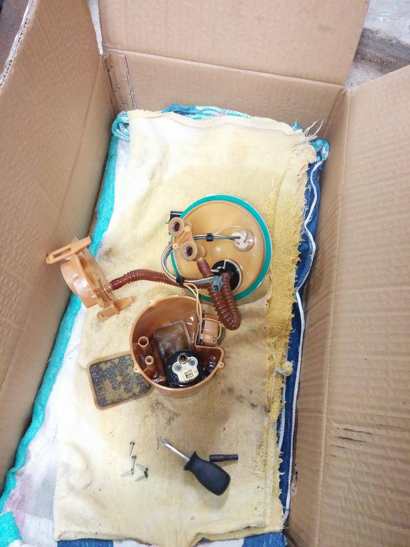

Here it is fully reassembled with the other new filter screen. Note how nasty the old screen in one of the photos above looks in comparison.
Also note that the red and black leads you see coming from the new pump are a new pigtail that was included with the new pump. As you can see in the first pic, the OEM pump has a 2-pin connector right on top that the grey female harness connects directly to. But the Delphi pump has standard male spade terminals and comes with an extra pigtail that has the female spade terminals at one end and the Ford 2-pin harness adapter at the other. I assume this is so that the pump can have a more universal application, but the box did not contain any other adapters such as you might expect to find with a "universal" product. I'm not real crazy about spade terminals in a 12V application submerged in gasoline, but after I got the canister back in the vehicle, I made sure the spade connectors were fully seated and secure before closing the "hatch."
