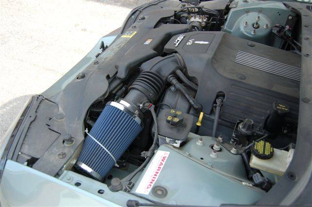

It would help if we knew the year of your car.
Here's my Autozone setup for an 04 which should be the same for 03-06.
I cut down the original airbox and used that and a universal cone filter which is available in blue, red, or grey.
There's just enough lip left at the shortest point for it to work.
That's all the parts required.
You must remove the MAF sensor before making the cut so it doesn't get damaged. Also the filter must be secured so it doesn't move around.
I used a couple of electrical ties in series.
Since this pic was taken I also cut off the silencer chambers that are part of the elbow and capped the holes for a sweeter sound.
Made a noticeable difference.
I bought a second complete airbox assembly off ebay for 45.00
to have in case I want to take my car to the dealer for engine warranty work.
Also wanted the stock airbox if I decide to sell the car down the road in a few years.
I cut some caps out of the big silencer chamber after I cut it off.
Roughed up both surfaces and used an adhesive we have here at work called Silaseal.
There's a second chamber that is on the underneath and is not visible in the pic. It's just a round hole.
Also added some sheetmetal screws and let it cure overnight as some guys have had the pieces seperate.
Break off any glue film on the inside that may come off and fly into the engine when it warms up.
I believe others have found that JB Weld which any hardware store has worked well without using screws but I like to have mechanical fasteners to make sure it doesn't crack like a year later.
You can also use rivets.

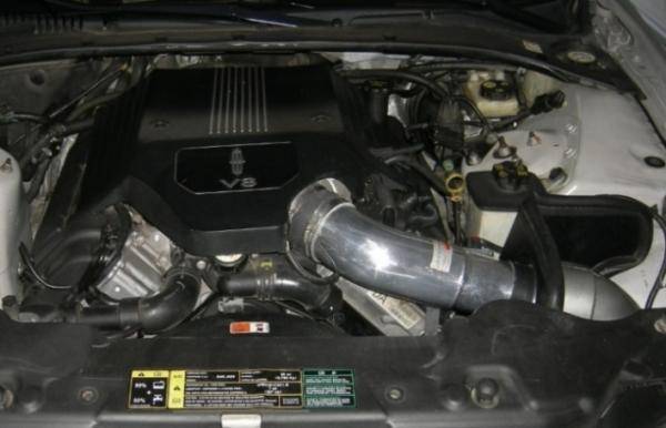

you could do it this way, im sure it will work about the same as my 00.

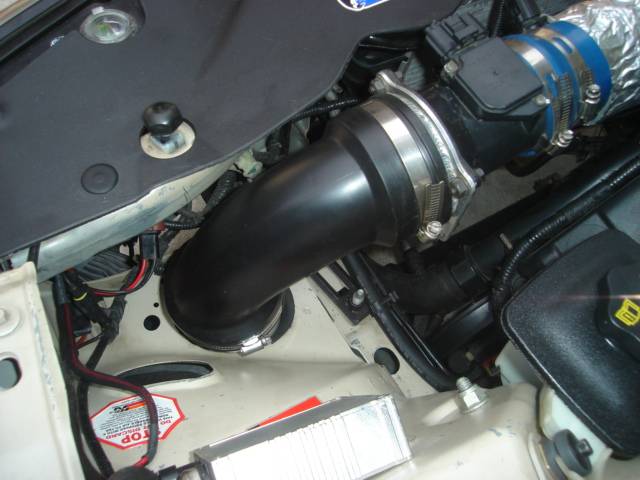

The problem with that is there's no boss to put the MAF Sensor into on the 03-06 cars.
If you got the right size elbow you could glue them together and add some fasteners.
I'd say there's a real performance increase and the sound is very sweet.
Going through to the underneath of the car will give you colder air but I haven't noticed any difference from when the engine is cold to when it warms up on mine.
Also there's a slight risk of picking up water in heavy rain and having it sucked into the engine.
You could star with my setup then go with the elbow later.
Some people put a second elbow in and have the filter horizontal in the lower grille also.

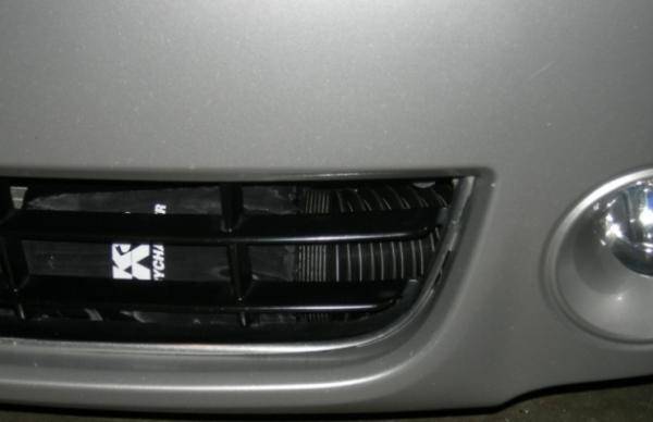

my filter actually sits right behind my foglight, keeping the overspray of water out of contact with the filter. When i go to the track i can also remove my fog light and have a ram air effect, i have seen a gain of few hundreths of a second in my 1/8mile time by doing so.
