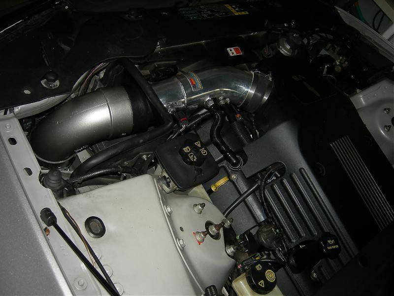

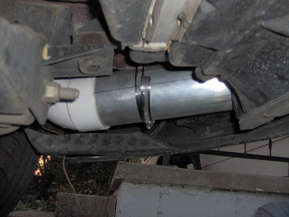

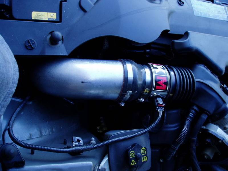

If you view my photo gallery you can see the build of my cai and ram air I guess you could call it..
I made it out of 3" 1/16"wall aluminum tubing and 3" thin wall pvc elbows, two 3" Fernco rubber boots for pvc. if you built it all out of pvc you could glue the elbows and coupling on but I used aluminum pipe so I had to hose clamp the pipe in the fittings kinda gives it that tunner look though, I like it sounds awsome and added a lot of pull to the power range on the car It just pulls and dont stop. kinda like an old big block car...

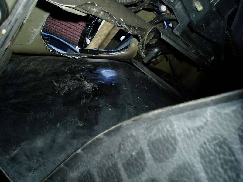

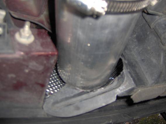

Didn't quite work out as I'd hoped.

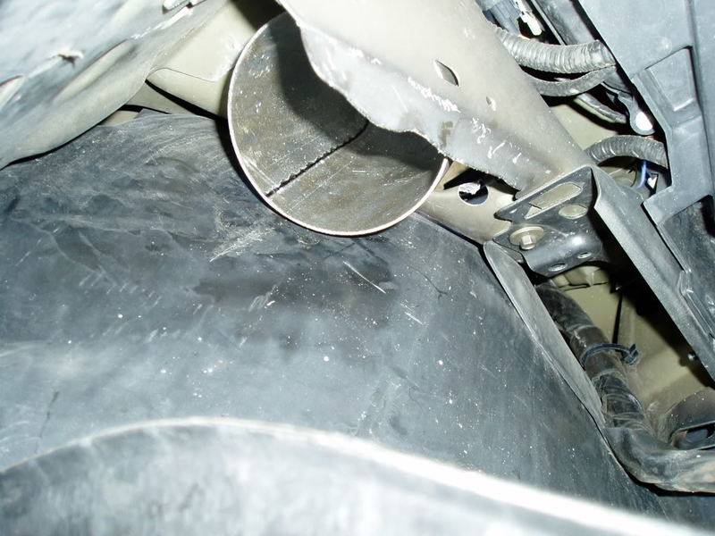

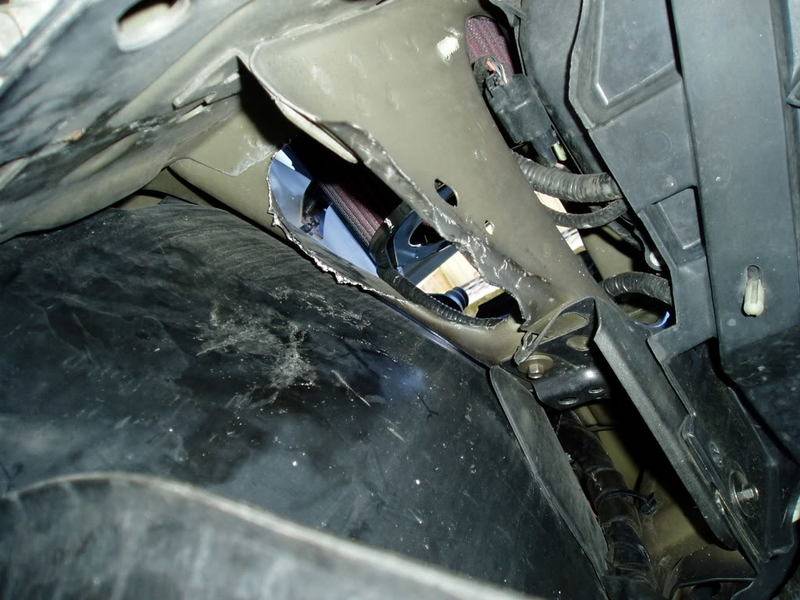

First off, the 4" pipe makes for a tight fit especially with that bracing in the way. I did my best to bend it out of the way, but with working on it at my apartment, I'm limited in the tools I can use.
Secondly, the filter sits FAR too low to the ground for a car that's kinda daily driven and driven in the rain. I'm going to have to get another 90 degree piece to make the filter go towards the bumper instead of the ground.
I AM going to run the pipe through the fender with no air filter when I run the car at the track. I also plan on picking up a 45 degree piece to replace the stock rubber tubing off the throttle body and have two fittings welded on to accomodate the vacuum lines.
With the 6" piece of 3.5" pipe, I was able to move the filter a little further away from the engine, which will hopefully help a little bit. The second worm clamp closer to the MAF housing is to hold the brace that comes with the KKM.
Wish it would've worked out. Sure looked cool going through the fender!

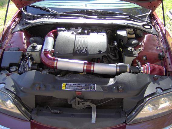

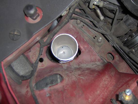

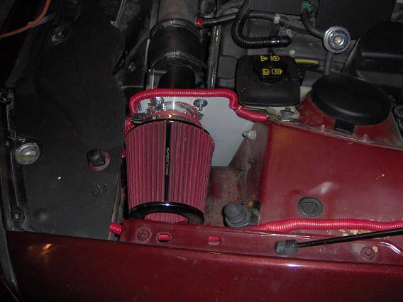

Ok I finally figured it out here we go... just a simple set up and now I have made true cold air and built a heat shield out of some stainless..hope I didnt put to many pics up sorry for inconvenience.:)
MaroonLS: That's exactly what I'm doing and it looks great! What are the dimensions of the shield?
You don't really need to route anything to it. Judging by the IAT readings from my ScanGaugeII, once the car gets moving, the air entering the engine is the same as whatever the outside air temp is. All you really need to do it block off the filter from the extremely hot engine air and you're all set. Like I mentioned in my ScanGaugeII thread, intake air temps I've seen on an 88 degree day were almost double the outside temperature while sitting at a light. Insanity.
