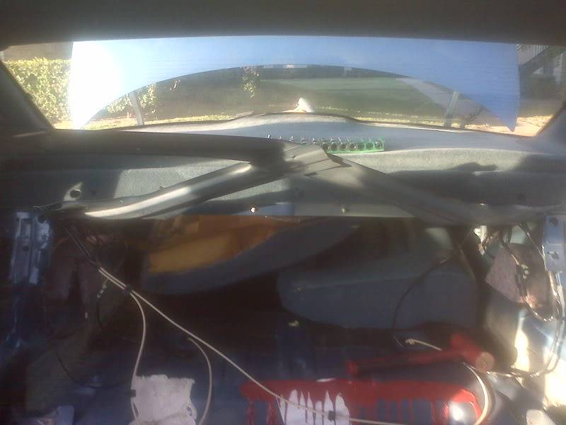

You want to do this.
not my car.
Lol that's my car, and I still say...cut the X out..it's useless
Eh, my socket tray is orange, that green one busted...you can see in that pic, when the X was already busted in the middle...looks like they sure hold up for sctructural support huh!!!
