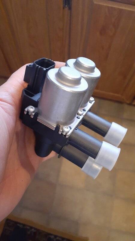

Just changed the dual climate valvle on an '05 v6 base model. I havent had the car long, and i opted for an el-cheapo replacement. The car needs a few other minor things, a set of tires, and i wasnt sure that the dccv was actually going to fix the problem. It did fix the issue, after replacing the blown fuse that goes with the valve. Anyway, i figured that i would go the cheap route for now to free up resources for other maintenance, but if (when) it fails again, i should be able to spring for the OE part next time.
Ive read the horror stories about aftermerket dccv, but it looked like that was already done to the car before i had it. The valve was zip tied to the mounting point. Between that, and what i was saying above, i was like screw it. The part got lost in the mail, so they shioped a new one out. Then the lost part turned up this past week, 6 weeks later. So now i have the new aftermarket one on it, and another identical one on my shelf.
I think i spent $40 thru Ebay. The part swap was real easy. It took longer to get the wire harness disconnected than it did anything else on the job.
With as much of a PITA it is to change the DCCV... I don't understand why anyone would want to install a cheap part there.
Aftermarket only lasts about 3 years... if that long. OEM will last 7-10 years... maybe more.
I dont know what the rest of you people are doing, but the dvvc on my '05 v6 was very easy to change out. I was in and out of the engine bay in half an hour. Quite literally open the hood and look down, to the left of the radiator, there it is. One attachment point, one wiring connector, and 3 coolant hoses. Thats it. Then changed the corresponding 10a fuse in the engine bay box, which is also right there.
I dont know. Maybe cutting my teeth on japanese tuner cars and european luxury brands has me spoiled, cause the dccv swap was like a 2 out of 10 on the difficulty scale, in my book. Ive spent more time changing oil on other vehicles than it took to do this valve swap pn the LS, and thats no exaggeration.
Fwiw, if the thing lasts 3 years, im cool with that. Plus i have that spare one that showed up, so that puts me at least 5 years to the good!! For 40 dollars and maybe a total of an hour labor? Seems fair enough to me. Seriously tho, the car has 150k. I bought it to use for work and get a blow n go put in for a while. Im not trying to restore the thing, or sink a boat load into it just to keep it on the road.

I will throw my experience in on it.. I buy and sell car parts, and I prefer used items I can rebuild, I went thru 3 dccv this year early on, I did research for weeks on best approach to save some money for this item (I have already dropped 10K into a new engine for my truck,) so finances are tight.. I bought one off eBay, from this guy who is a new store owner- I paid $38 for this heater valve and think it had Bosch solenoids on it, looked new, or could've rebuilt I'm not sure nor worried. I'm going on 6 months of perfect operating A/C and heat system as well as no run hots, car will not go over 221.8 degrees ever. This unit has a 2 year warranty with labor!!!!! Haven't experienced having to use it I'm just glad its there in the event. I had to go this route, $38 every 2 years is worth a chance to take for me.. If anyone interested ill give his name, and tho I don't endorse aftermarket parts at all I have to vouch for this one and only.
