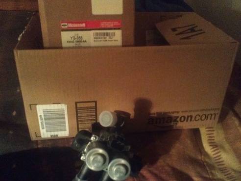

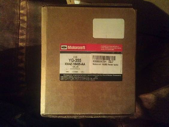

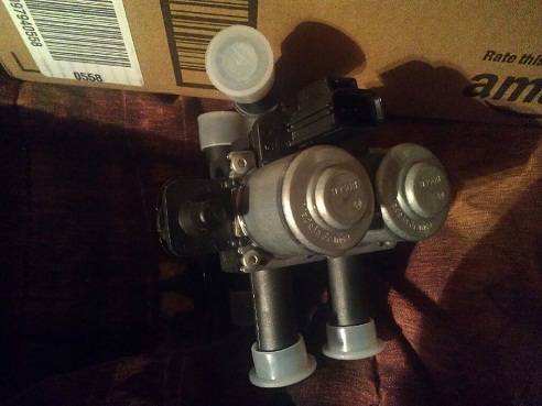

Found a "like new" Motorcraft DCCV on Amazon for $118 shipped. I used to work for them so I know that "like new' meant that someone slightly damaged the original box at the warehouse so they opened it, visually inspected the DCCV, and repackaged(re-taped) it. Bezos has relatively tight quality standards so I was comfortable purchasing. No more purchasing a cheapo off brand DCCV for me. Lesson learned. Next Wednesday appt to have it changed.
