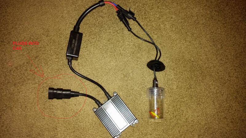

can u take a pic of how you set it up so I can better see what the issue may be

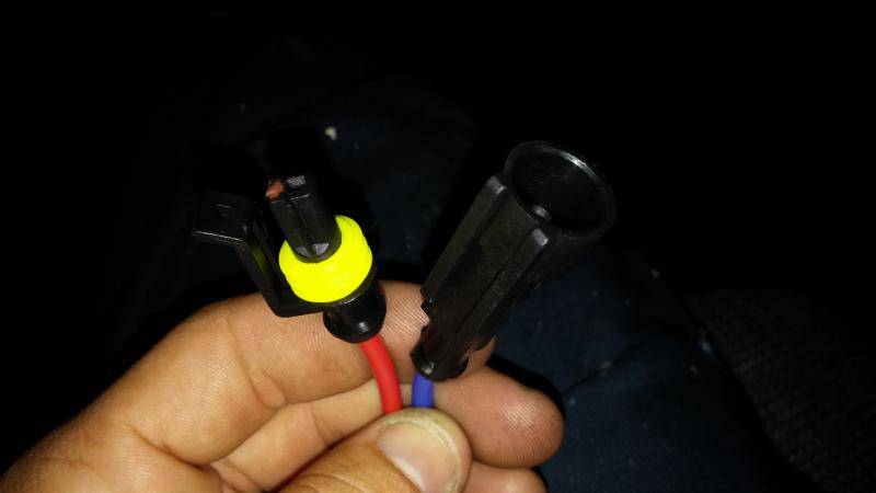

So I'm assuming the red and blue wires that come out of the ballast and into the HID bulb need to be reversed, because those are what have the tiny red clips. Well, the red line does anyway, I wouldn't see how the blue one would come out.
Hopefully these help..
If I do what you're saying Chris, I don't need to pull any wires or anything right? Just turn the connector backwards and connect it?...
the one that plugs into the car might have to flipped around , everything else looks good, but double check if everything is well put in , oh and when you turn on your car make sure high beams are off because on my LS the fogs dont turn on when the highs are on

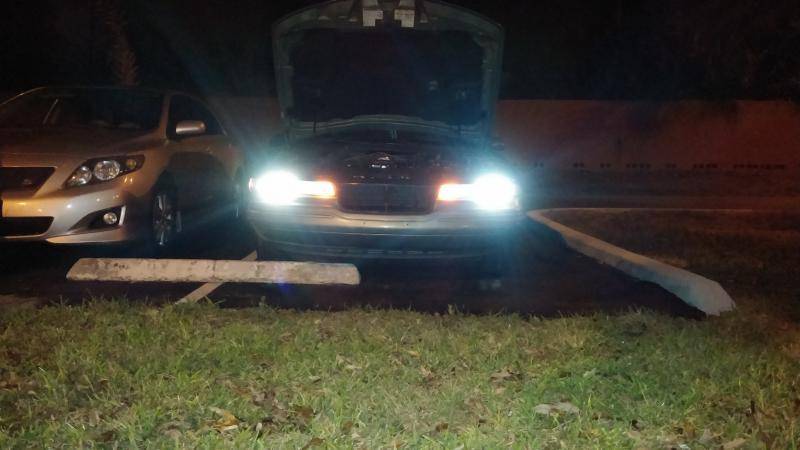

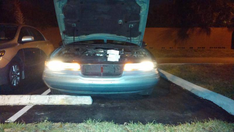

BEFORE
AFTER
There is a street light above my car so you can't tell the difference on the ground but WOW, I can see now lol.
