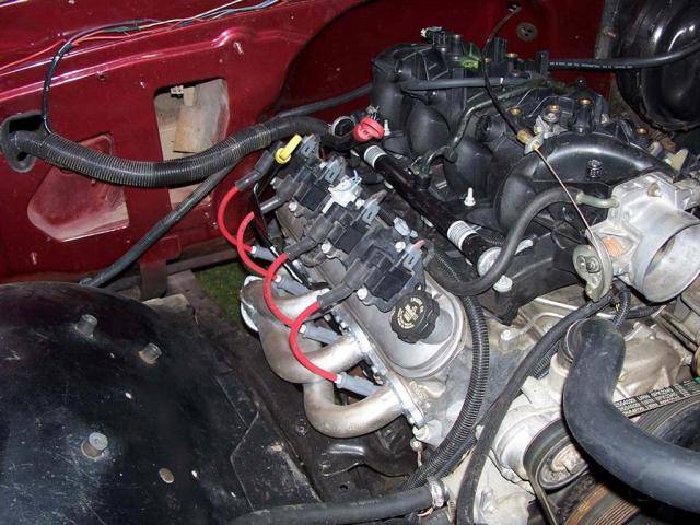

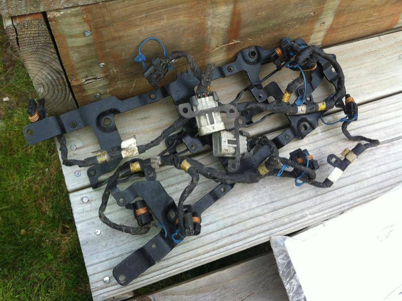

Really, if I were going to keep my LS I'd be investigating what it would take to use the GM coils on the LS and that includes building the custom bracketry that would be needed in preparation for the inevitable coil failure. I haven't looked into the wiring, but the hardware is easy enough. The Chevy LS coil would require the use of actual spark plug wires. For this, you would want a set of overhead cam plug wires similar to the ones used on the Corolla, where the wires go straight in and have a rubber plug to seal against water. Use a hole saw to drill 4 holes in the existing LS coil cover that will allow the plug wire seals to plug the holes. Building brackets that can be bolted to the engine are easy enough to make. I don't know how the LS connects up to its coils, but on the Chevy it uses a single plug on each side of the engine to connect to a mini-harness for the coils on that side. The correct wire terminals and plugs are easily available on the internet.
Even if the LS coil were electrically incompatible, the same process could be used to add any compatible coil. In fact, the same process could possibly be used to mount stock LS coils outside the coil cover since it's possible that the coils being under those covers is causing the coils to run hotter than they should be which may be contributing to their poor durability. Using stock LS coils would solve the wiring issue as well, since there wouldn't be one. I can't imagine there would be a problem with the coils not being under a cover but if being exposed to the elements is a problem they can probably be sealed.
Picture of the LS brackets and wiring harness
Coils on the engine
