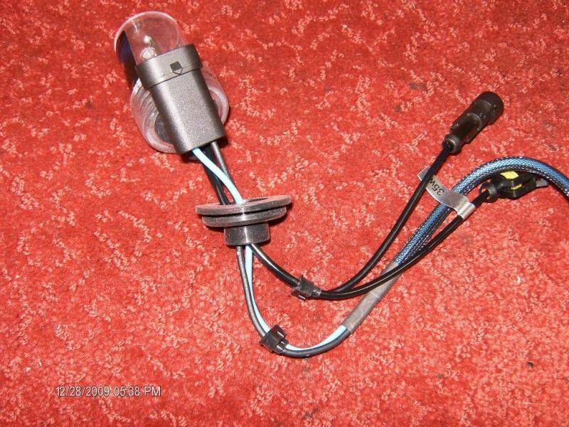

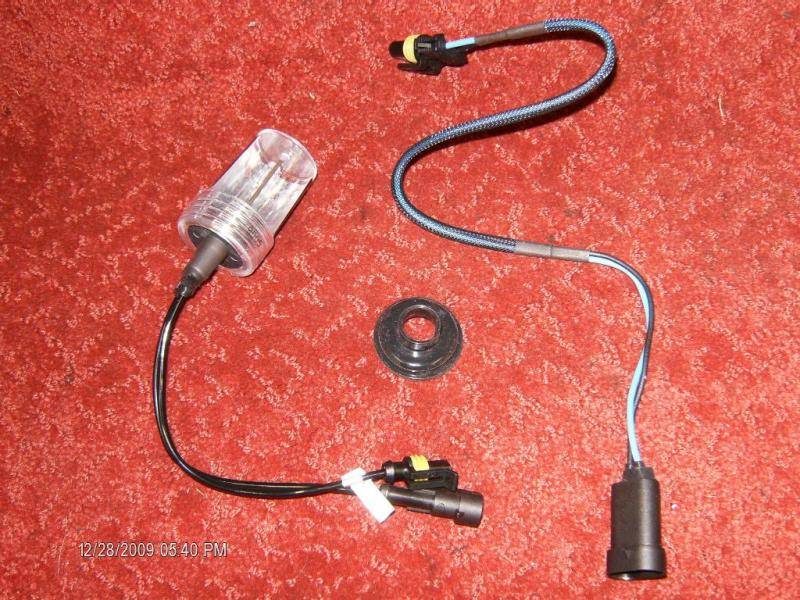

dlf- i have the kit in my hand it doesnt not come with the piece that i menioned ealier what do i do or can u make that peuice for me and ill pay extra for it?
No, I can't make that. Strange, it comes with every bulb I've seen.
should i just buy a new hid kit 9006 from that place DLF recommanded
