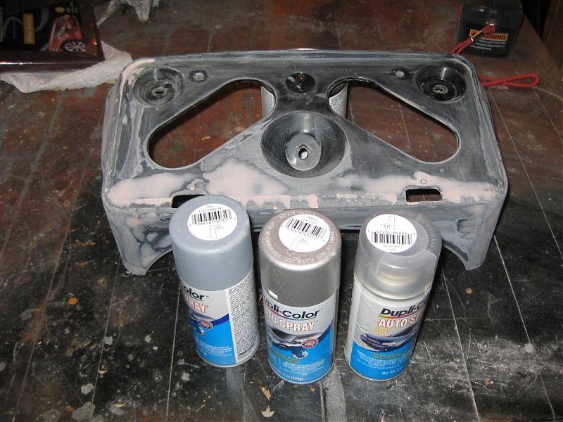

Any idea who has these Duplicolor paint in spray cans and do you need clearcoat for the black? Lincolns clearcoat I believe is mixed in with the Lincoln paint.

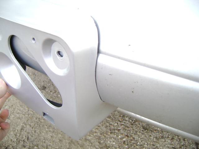

Ask and you shall receive... :)
Wow... that don't look bad at all!
Especially when I started with this... I got to play Jamie for an afternoon!

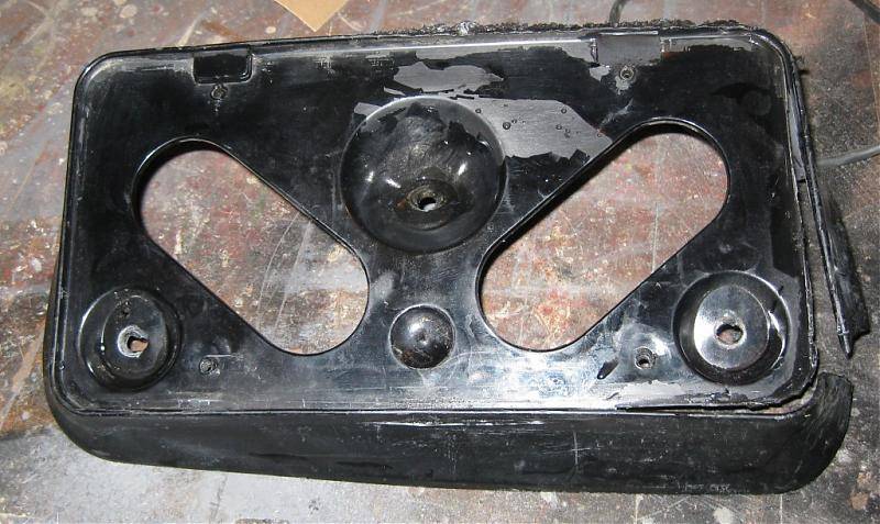

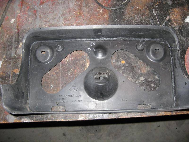

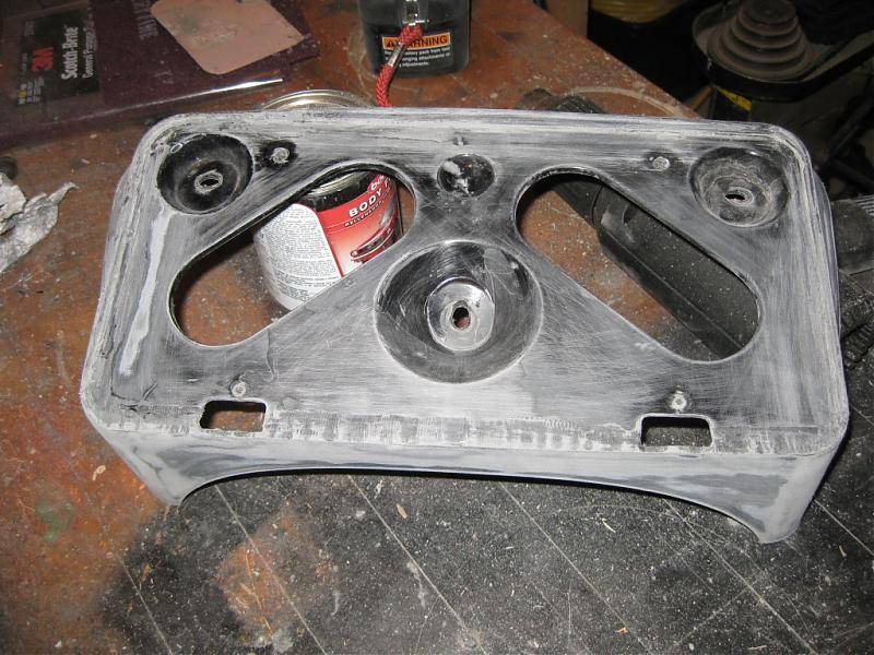

Here ya go... I used 30 second hold superglue to get it to stay in shape, then I used some plastic epoxy to give it strength. Used about half a tube, wanted to make sure it was good and glued.
