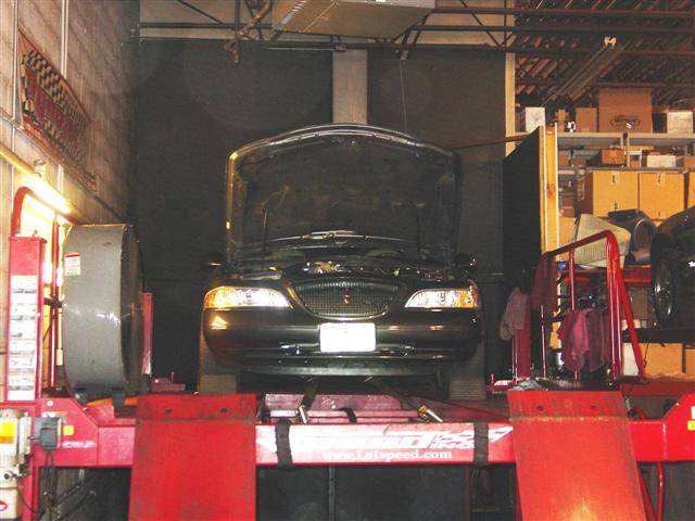

248 rwhp
241 rwtq
252.83 RWP
I cant give an exact on the Torque because the graph screwed up a bit at the end and shows 287.78, which is wrong. But it looks like about 254 RWTQ
Cant say I know much about these things to be honest, but I bet I'll be learning alot shortly. I have videos, but the camera is in the car and im too lazy to go get it right now. A little later.
One interesting thing, is that it appears I have gained in gas mileage. I cant say for certain, but it looks like I picked up about 3-4MPG so far. That may not sound like much, but at 1 tank of gas a week, thats a savings of about 2-3 gallons of gas per tank, and 300-400 gallons per year. So at todays gas prices, it was well worth it to have the tune done.

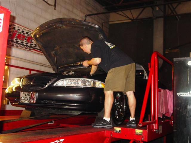

Here are a few shots from the dyno today....

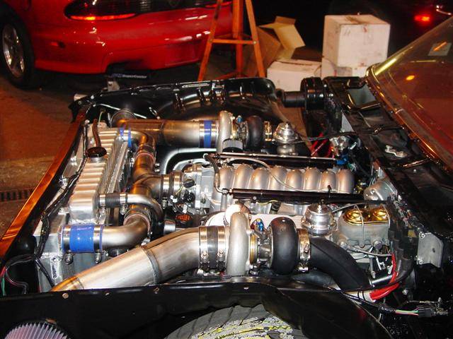

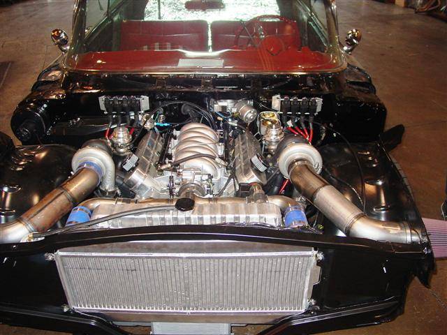

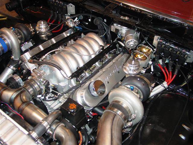

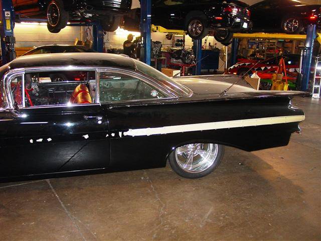

The second set of pics are a car they are working on that looks like it will be quite mean...

Nice numbers Joey... what rpm did you make peak horsepower at? Is that a twin turbo LS1 engine?
Congradulations Joey. I like your front plate. Arent you lucky you have gold members ....:D
Yea I too like that impala 59 or 60 allways like those body styles. That thing must be a rocket:eek: :eek: :eek:

It was a pleasure meeting you and tuning your car. I am pleased with the results. If you had stayed 5 minutes longer, Glen with the Mark8 showed up. You guys could have talked about INTAKES!! As I told you, let me know if you have any issues or want to change shift points. I will get that taken care of asap!
As far as gas mileage, it sounds like what I told you. The computer was trying to compensate by pulling 25% fuel (max short term) prior to the tune.. Now the short term trims are right in line and the WOT was leaned out 10-11%..
