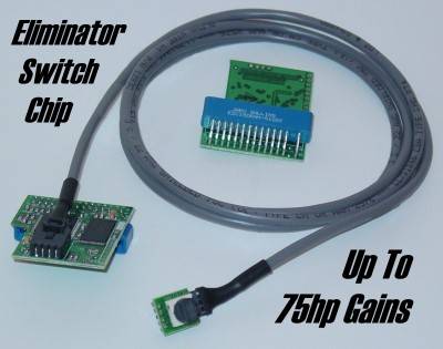

your mark is OBD-I - I went to the sct website and couldn't find much information about their chips for our obd-i cars. You have a chip with selectable programs? Are they selected through a switch in the car?
Yes, it is a small rotary switch. I mounted it through a drilled hole under the dash in the removable trim beneath the steering column. You can have 5 programs - one being the stock program.
* - 75 HP in diesel chip only
Product Name :
SCT 6600 4 Program - 4 Bank Chip EEC-IV and EEC-V ELIMINATOR SWITCH CHIP
Product Description :
Six Function, Four Program - Four Bank Chip
User selects one of four programs via a dial 0, 1, 2, 3.
Program 4 is the FACTORY STOCK
Programs 5, 6, 7 NO START
Geno, do you now sell 4-bank/5-program switch chips?
Product Name :
that's really ,really cool, i had no idea that was available.
