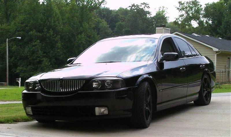

The grille and lenses look good on that silver man!

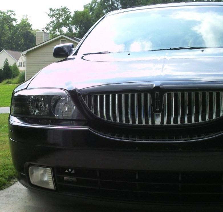

Check it out
Thanks again J!
Nice! Looks like you went pretty dark?
Tell me how surprised and excited you were when you realized it actually works?:D
It almost looks darker in the picture than it actually is but it looks great in person. That yellow side marker really stood out from the rest of the black/red/chrome on the car.
It was surprisingly easy and being inside the headlight housing, I wouldnt expect it to fade any time soon.

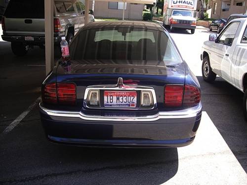

heres my tail lights, not much diffrence even after sitting or alomst 2 hours, i used a pretty thick solution. my inner tail lights didnt want to change at all, my inner drivers side looks alot darker because there was some water in there when i got the car and it ate away alot of the chrome on the inside. but over all didnt get to darkness i wanted and was sick of waiting so i gave it up. make sure you dont have any light colored countertops when you do this i made quite i nice speckled effect on ours. good luck to anyone else who tries it, hopefully it comes out a little better then mine.
not what I was expecting on the taillights...
Maybe I should just stay traditional and get the film or spray...
