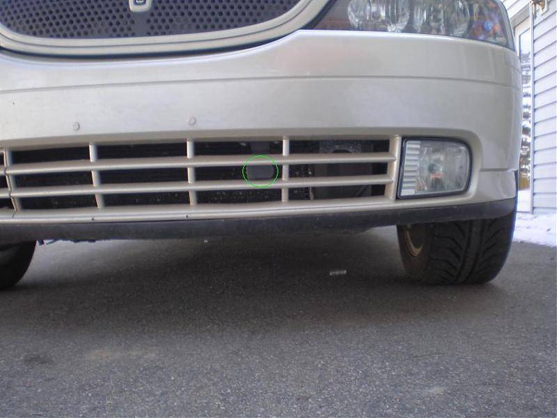

Being in Canada and today at minus 28 degrees BRRRRR I was looking for a blockheater cord on my 2005 LS. To my surprise I found a small cover in the front bumper cover with 3 terminals so I believed this was the block heater cord connection but the position of the terminals where different from the normal heater or extension cords. So I got in touch with LM and would you believe the cost of this cord was $180 + taxes Canadian which absolutely floored me. What I did was made up a cord to fit this receptable and being in an underground parkade have not had to use it. If anybody has an original cord for sale please let me know. :eek: :eek: :eek:

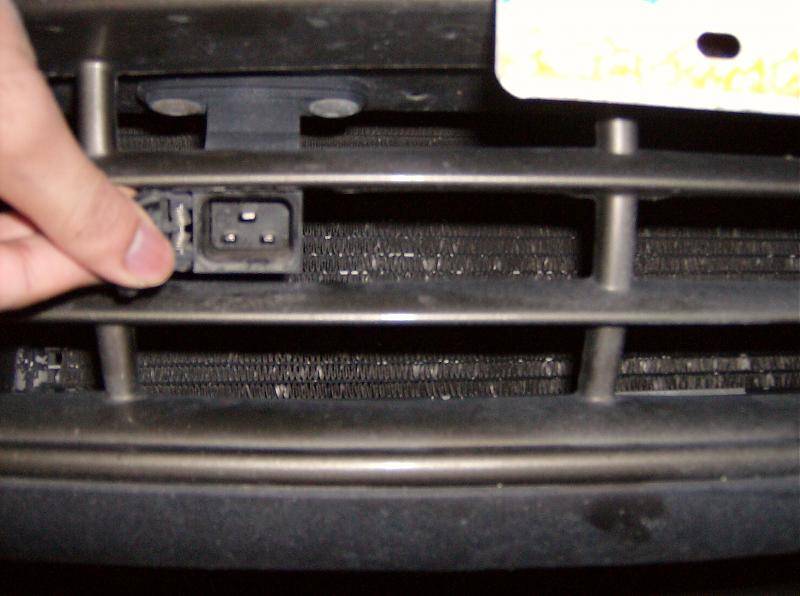

Using Google, I found that this weird plug was used on some computer servers. I went to Tiger.ca and ordered a 10 foot cord with this C19 plug on one end and a regular 120V plug on the other end. Cost? $17. With shipping/tax, about $24.
However you need to do a small modification...the 'shoulder' of the plug is too close to the end and this prevents the plug from being inserted far enough into the receptacle in the grill. So I used a Dremel and modified it.
See pix.
It was -29 degrees last week but by the time I got this cord it was only -15. Now I'm waiting for a return to cold weather to try this.

Anyone have pics of this cover. I'm curious if my car has the block heater??
It's in the lower front grille on the drivers side.
