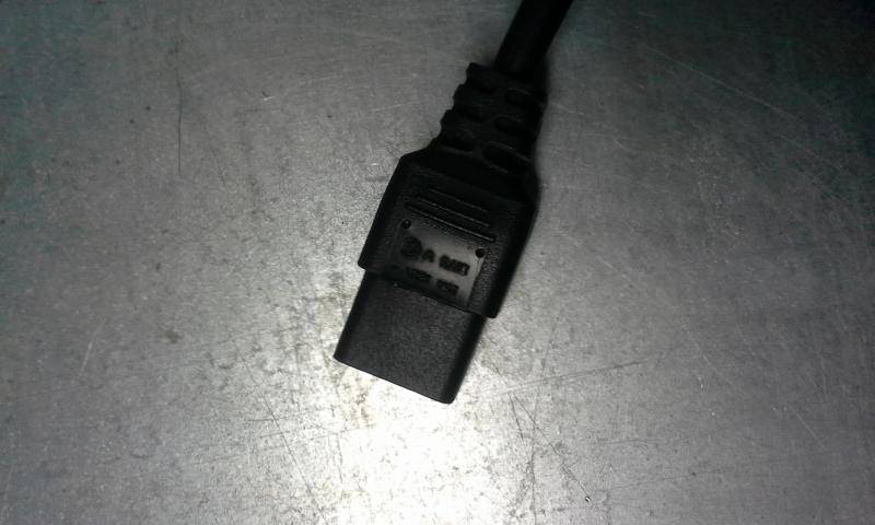

I found my culprit. Wasn't my extension cord from the house, but, the cord supplied with
the car. I discovered humidity entered the cord from the small holes in the plug itself on
the car side.
I checked for resistance and only found some on the Ford cord. Left it in the house for about
a week, and checked it again, and this time, it was good. Began using it again, only to trip my
breaker again about a week later after having had some snow fall. Removed cord, and checked
again, resistance appeared again on my meter.
Put it near the wood stove for a few days, and then began to examine the cord, when I noticed water
residue around those two tiny holes. Filled them with dielectric grease, and have been problem free for
many weeks now.
Just thought I'd post this if anyone else has ever had this problem, or, someone in the future faces this
situation. I know not too many people use the block heater, except for a few of us Northern folk.:rolleyes:
Below is a pic of the cord with the holes I speak of.

Wasn't it just a computer cord with sideways pins?
This one, a C19: http://www.showmecables.com/product/Power-Cord-NEMA-5-15P-to-IEC-60320-C19-1-FT.aspx?utm_source=google&utm_medium=cse&utm_campaign=44-109-001&zmam=49733141&zmac=5&zmas=1&zmap=44-109-001&gclid=CjwKEAiArqKmBRCOj_qfmuqinnYSJAAkAYwGOJeDhgywarcY0D4N-sQ9SNxH8gUtcL6OnydNhqEQcxoC28Lw_wcB
Googled "computer cord with sideways pins". Second result, third suggestion to an oddball Dell PSU. Maybe a special amperage rating?
Not trying to steal Rig's potential customer, but there's no such thing as a unique plug... Proprietary, sure, but a block heater in a Ford seems like an uneconomical item to go all Apple on it.
Kidding me? I'm gonna list it on eBay and set a reserve of at least 500$
it's a Fn Ford cord, it's the holder plugin in the grille that makes the cord so special.
which I already nixed out of my LS. drilled the awkward fasteners right out of the bumper and fished the remains out from behind. Stupid thing!
There wasn't actually ever a block heater on mine, just the empty cord receptacle in the grille.
