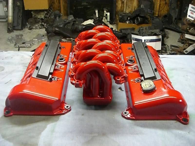

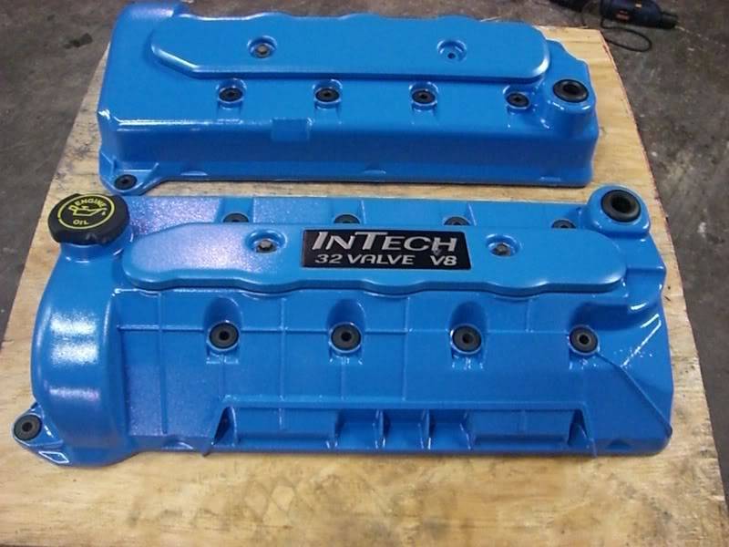

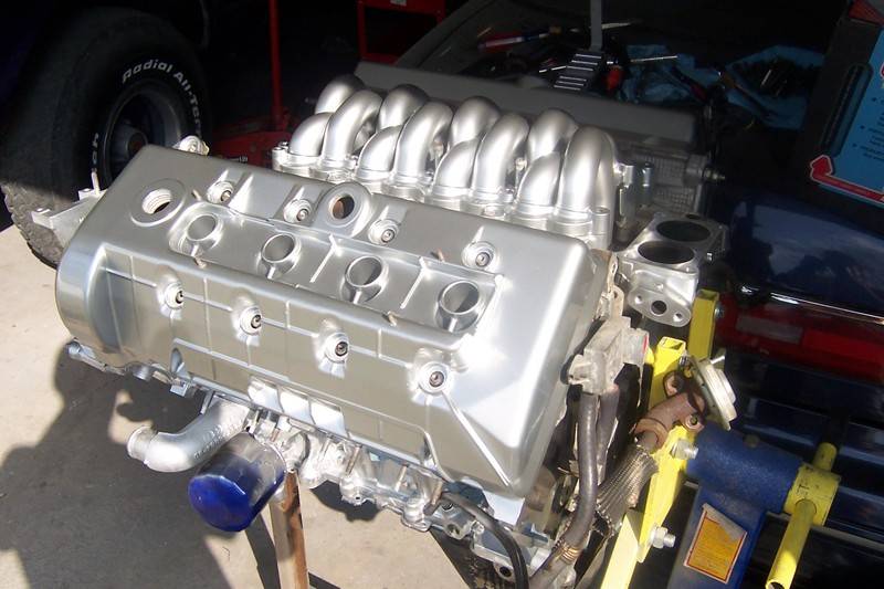

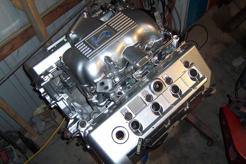

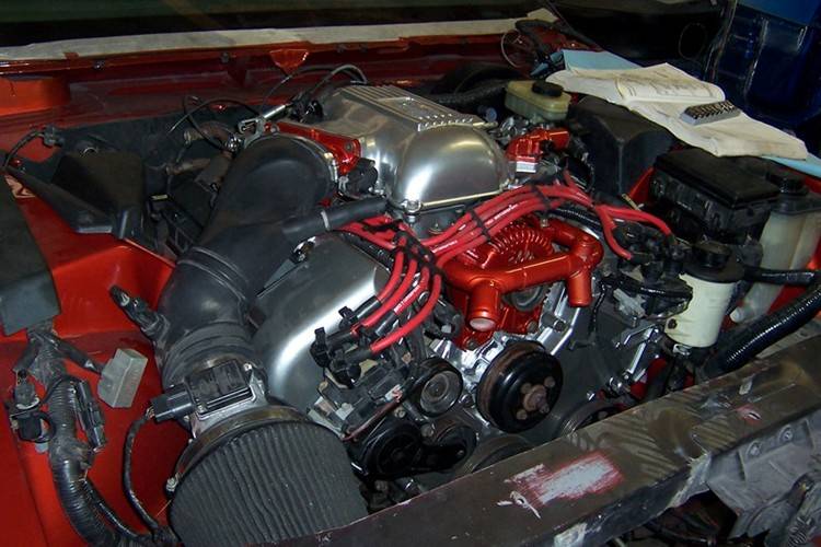

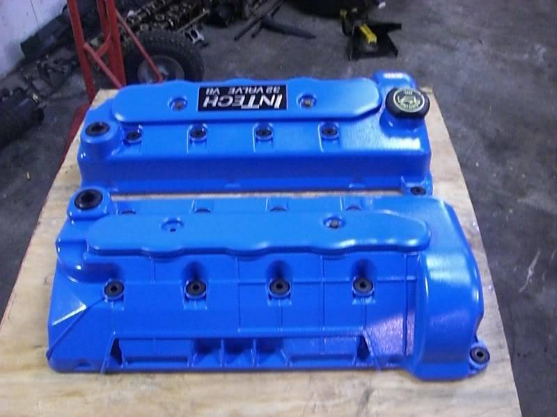

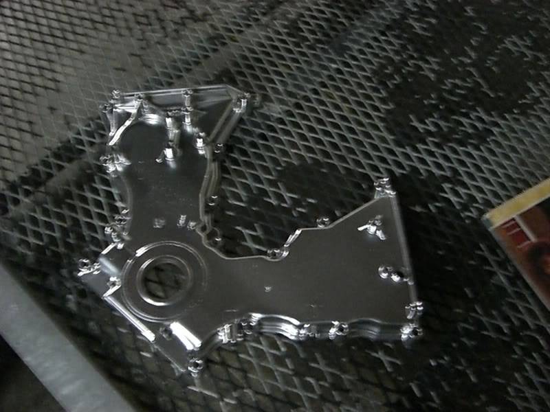

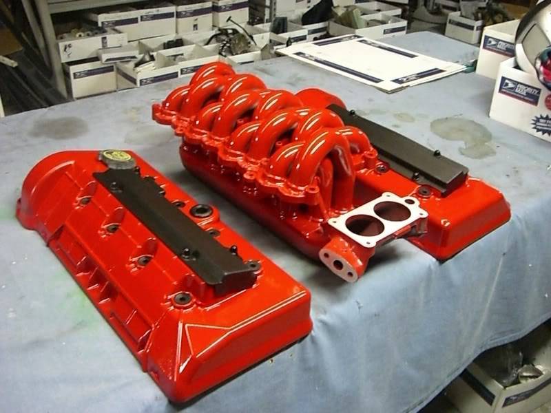

i'd be scared of the outcome for that price, the powder alone costs that. i was offering powder coating but no one seemed interested. this is a few of the things i did then said screw it. the chrome intake and valve covers were my personal 98, the red intake and valve covers were for jesse on LOD and the ford blue covers went to another member there, the chrome timing cover went to jeff from from mark VIII's of the state in new york. i tried to get this all rolling and see if it would take off, it took off just like all the florida mark VIII meets we had lol.
all this stuff i did myself with a regula oven and an Eastwood Hotcoat gun.

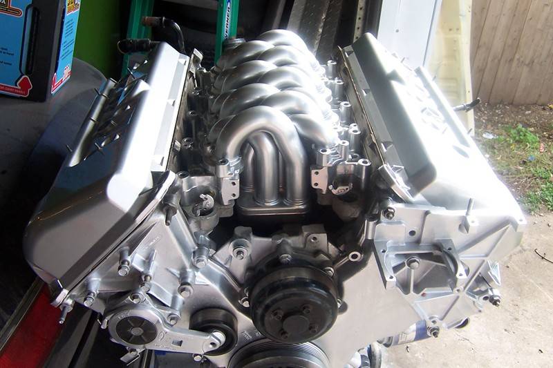

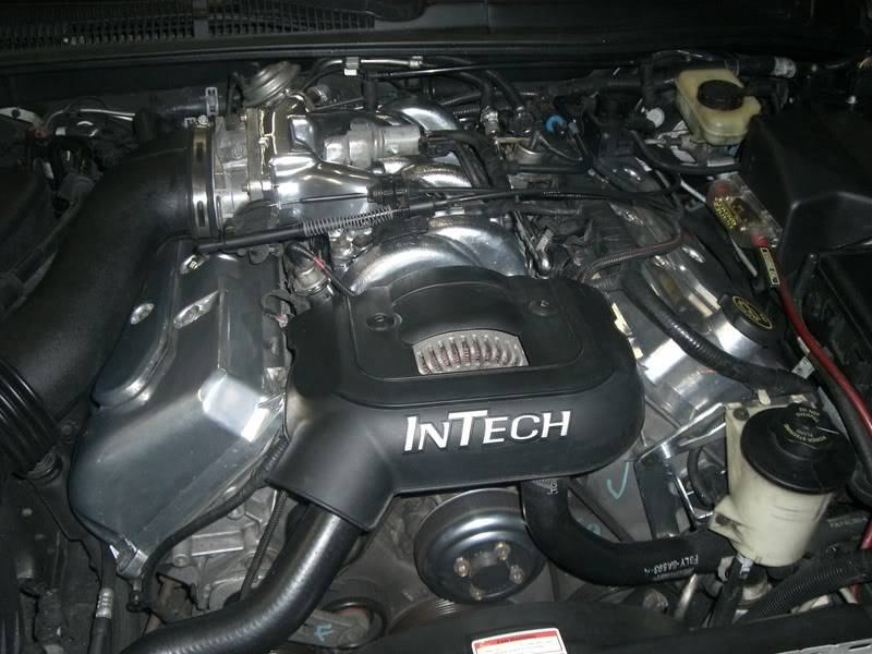

this was my 98, i did the power steering can bracket, water pump pulley, and alternator bracket chrome too since i had it all apart anyway.

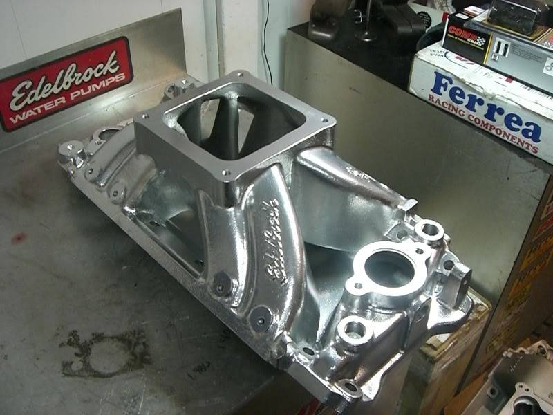

big block chevy intake i did chrome too.

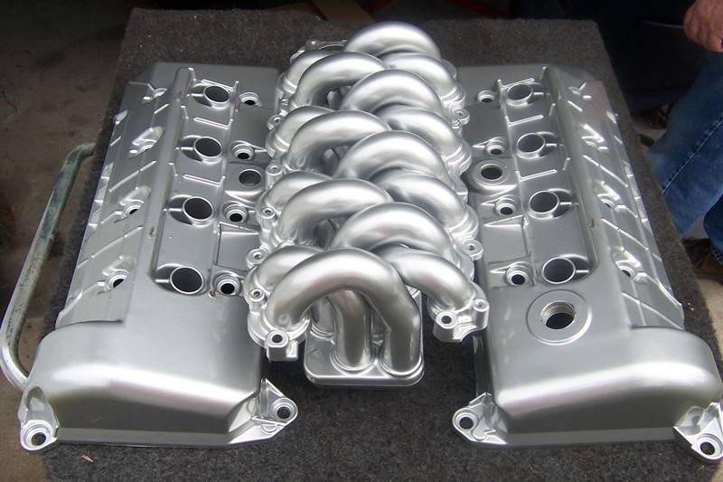

1st gen intake and valve covers
well it depends, if you look closely at my intake, i had it on the work bench for about 3 hours with a dye grinder and all different kinds of sanding and polishing bits to smooth the whole thing out, powder caoting the rough casting would look like crap, making the intake smooth first then powder coating was so worth the labor. honestly, i dont think its worth me even doing, what you would think it should cost and what i would charge to make it even worth my time are probably 2 numbers with a big gap between them!! i'm sick of working on things for next to nothing, and i always put way too much labor into jobs because i like them to look perfect, i always screw myself.

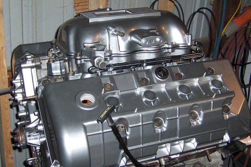

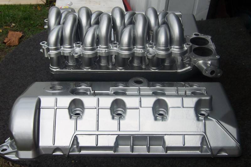

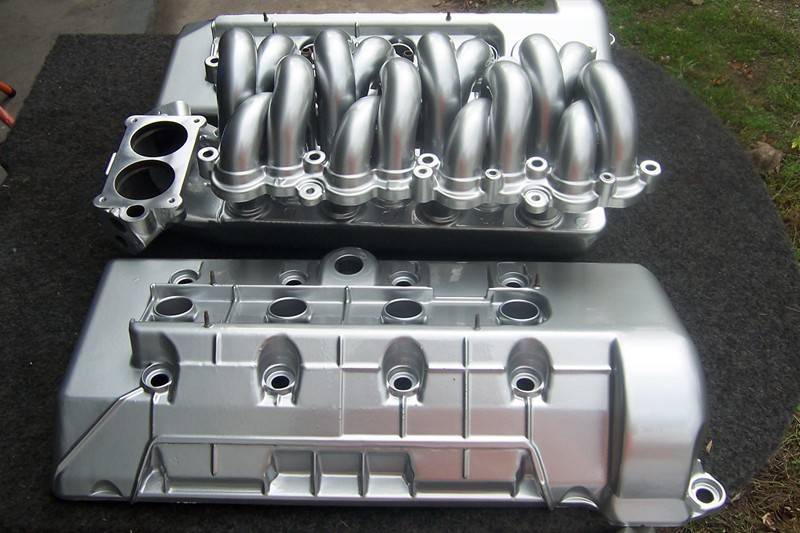

Here are the covers in the 94, and the old 95.
There was no buffing or polishing of the gen1 intake to make it smooth. just hit it with the sand blaster to clean it, and shot the powder.
