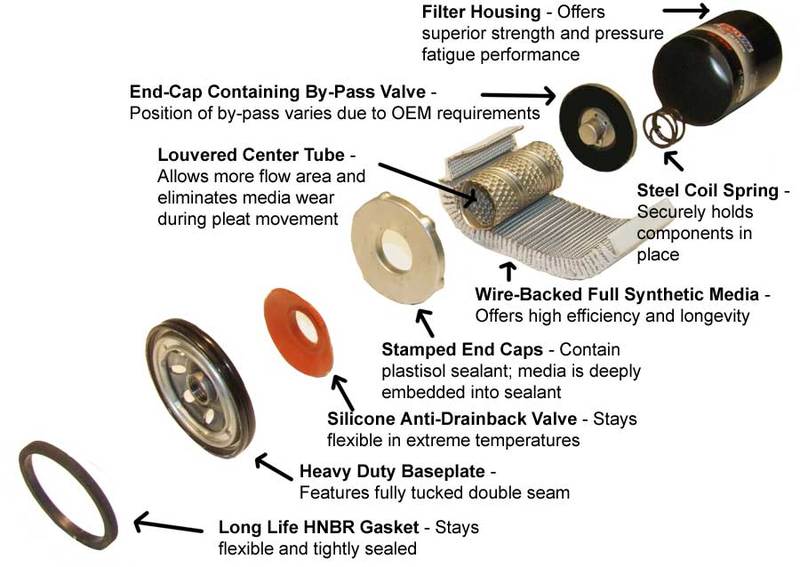

Oil PRESSURE perhaps, but it does raise an interesting point. Perhaps something in the engine is letting pressure bleed off due to wear, or the oil filter's antidrainback valve are no longer made well enough to keep the pressure up. Thinking back, I've noticed since I last changed my oil and filter that my car does not act up nearly as much as it was before the last oil change. This would imply that I had a defective drainback valve in my last oil filter.
Checked and see that both the 2003 LS V8 and the 2003 Jaguar S-type 4.0L use the same oil filter. I wonder how a factory Jaguar oil filter would do on this problem.
AFAIK, there is no anti-drainback valve in our filters. (The valve you see at the bottom of the filter is a bypass valve to let oil around the filter if it becomes too clogged. Dirty oil is better than no oil.) I have looked on the parts diagrams to try and find an anti-drainback valve in the engine or oil filter adapter, but I haven't found it.
That one may, however the Motorcraft one specified by Ford for us does not seem to have one.
http://www.summitracing.com/parts/acf-fl2021
I don't know how much you can trust Summitracing's pages. They also say the FL-2021 has no bypass valve, but I know that it does. I can tell you that I've looked at the Motorcraft filters and there is a bypass valve, but there is no check valve. You might want to look at the Wix filter to see if there really is a check valve.
Since I don't have a spare filter available I checked the horse's mouth. Wix says they do. And, I'm pretty sure I remember seeing an orange ring visible inside the outer holes.
http://www.wixfilters.com/Lookup/PartDetails.aspx?Part=57302
A NAPA GOLD fikter is made by WIX and is the same filter , NAPA Mgr. told me so I put it on with last oil change with my usual Mobile 1 5W20 and NO HELP ! Had heard same thing , just seams to me we have something else causeing this because it never did it all these yrs & miles with the Motorcraft filter it calls for ! Hope before I pass on someone finaly figures this out !
