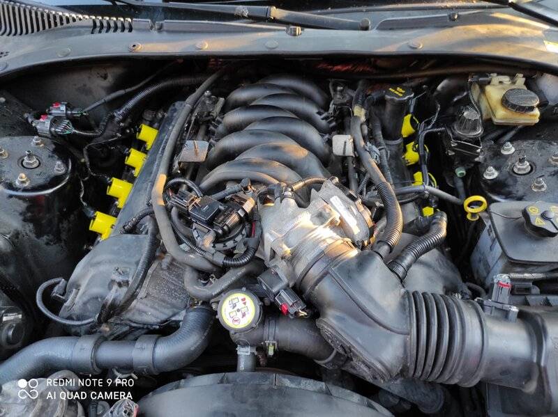

I have never had a smoke test done on any of my LSes but I actually believe/trust FORD with this decision/suggestion that a smoke test is the proper way to go about finding an air leak in the systemWhile Ford recommends a "smoke test" to check for vacuum leaks... you could try spraying carb cleaner in the 5-6 area... and see if the idle speed changes. That would indicate gasket or intake leak. Just keep in mind that carb cleaner is flammable. Mass Air Flow cleaner would work too.
I have never had a smoke test done on any of my LSes but I actually believe/trust FORD with this decision/suggestion that a smoke test is the proper way to go about finding an air leak in the system![]()
The 3000 RPM limit in park and neutral is normal. Rev limiter.
If the carb cleaner doesn't reveal a vacuum leak... then you might want to think about sending out your PCM for testing. SAI, (or SIA), is the name of the place to send it to.

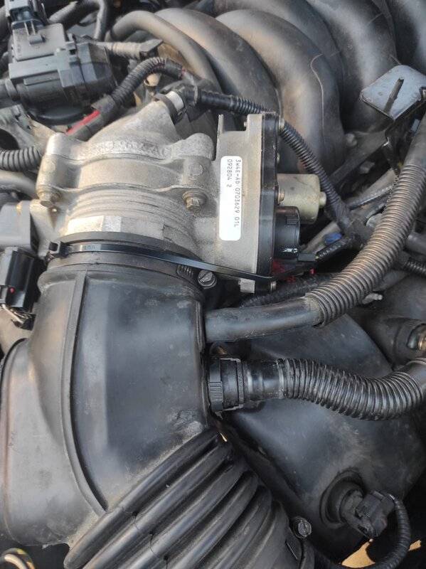

Forgot you had a new throttle body. While that is probably not the issue... It would probably be best to swap it in anyway... and I would get a new gasket
...I just dont understand the slow rev up thing. Thats NOT normal. It slow revs stock or tuned. Something is wrong there, and I don't know what is causing that.
Revving up slowly in park/neutral with the "stock tune" is absolutely normal and intentional.
If I go ahead and swap the throttle body, do I need to reprogram it? Or is it swap and go?
Thanks.
Question about the MAF.
The CEL is now on. I'm about to work on the throttle body, so I disconnected the MAF and decided to start the car, to see if the behavior changes. Notta, car runs the same with MAF disconnected.
Can the MAF be failing and cause this issue?
Disconnected, I got code P0113.
I thought we covered this in a different Thread LZ started...must have been a different guy ...that would be MISFIRE 101...always check MAF first ...for sure with the Lincoln LS...that would be nice if that is the only problem with the Failsafe...MOTORCRAFT ONLY PART!DUH!!! With all the talk about the misfires and coils... I forgot all about the MAF.![]()
It would have been better to keep this all in the original thread.... and much easier to reference.
Well wouldn't it be interesting if replacing the trottle body fixed the issue.
I wonder if this code: "P2105 - Throttle Actuator Control System - Forced Engine Shutdown" was pointing to it the whole time.![]()
