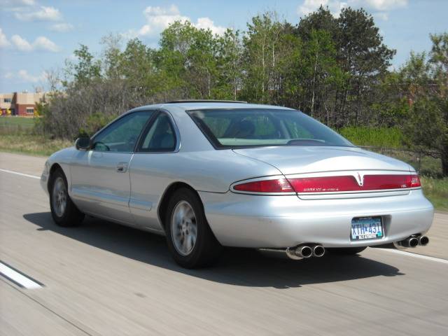

On my car:
Here's a crappy video of the exhaust with kooks headers, x-pipe, and 2.5" piping. Trust me, it sounds way better in person rather than on a crappy camera phone, lol. It's a compilational video but you can get an idea at the beginning and then at the end when I fly by.
http://www.youtube.com/user/MrHotrodlincoln?blend=8&ob=5#p/u/13/TDYQuL7PM2w
Not telling anyone what to run, just telling you what I run. ;)
