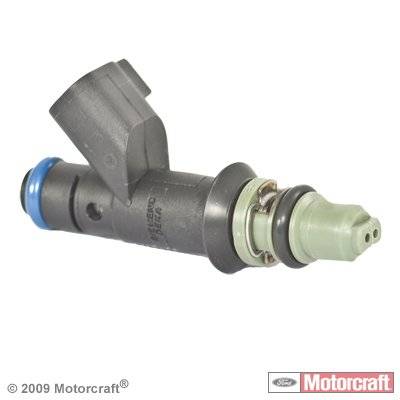

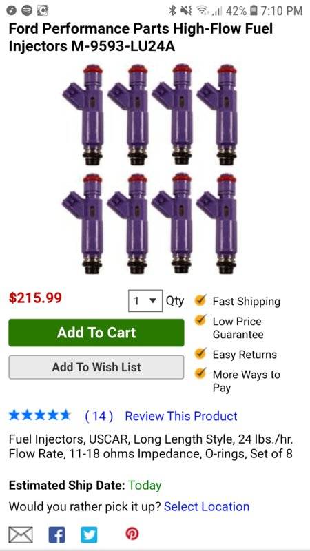

I don't know if those injectors would fit correctly. The nozzle on the factory injectors are longer. Our injectors are unique to the LS and Thunderbird, but I can't find specs on what exactly is unique
The purple injector's page also lists a bunch of possible connectors they could have. You could probably figure something out with a bunch of different injectors on hand
LS injector:
M9593 page: FORD RACING 24 LB/HR FUEL INJECTOR SET

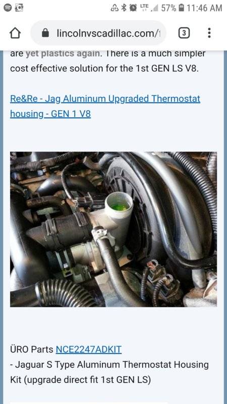

Quick question, how full should the thermostat housing be? Is this good?
