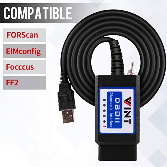

You will need to purchase a bluetooth OBDII adapter and download torque, forscan lite or if you have a laptop with windows download Forscan app for free and buy an ELM27 adapter to plug into the car under the steering wheel OBDII port in the Cabin ...and see what your true coolant temperature is registering...the coolant needle will stay in the middle when coolant temp is 190-239 but at 225 your car is already over heating because a proper running coolant system should be registered at 190-195 200-220 is actually running hot and 220-239 you might be walking home ....

Where would I find one of these? Just buy one off Amazon, or is there a better place? What is the price range?
Panlong Bluetooth OBD2 OBDII Car Diagnostic Scanner Check Engine Light for Android - Compatible with Torque Pro
Amazon!
FORScan OBD2 Adapter, VINT-TT55502 ELMconfig ELM327 modified For all Windows compatible with Ford Cars F150 F250 and Light Pickup Truck Scan Tool, Code Reader MS-CAN HS-CAN Switch

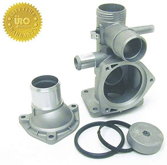

URO Parts NCE2247AD-PRM Aluminum T-Stat Housing Kit
  • Motorcraft YG355 Valve
