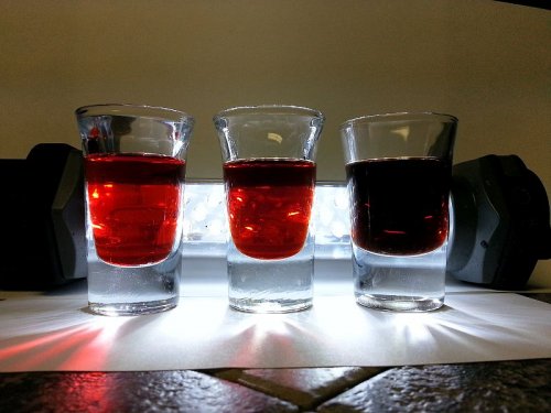

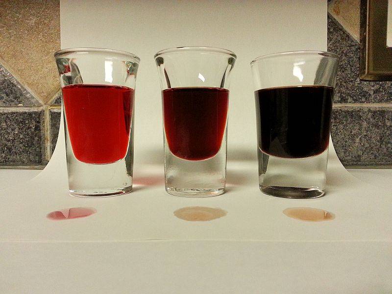

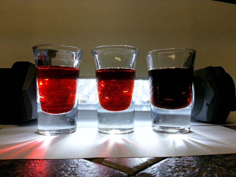

... It was a slightly brownish dark red. Certainly needed replacement ...
I remember that day! LOL ... we had people over that night, was trying to get them to do shots with me! No takers!
Did the P/S at the same time.
Should really be doing all fluids again soon myself, wanted to try and run the seafoam through the Hydraulic Fan next time around.
