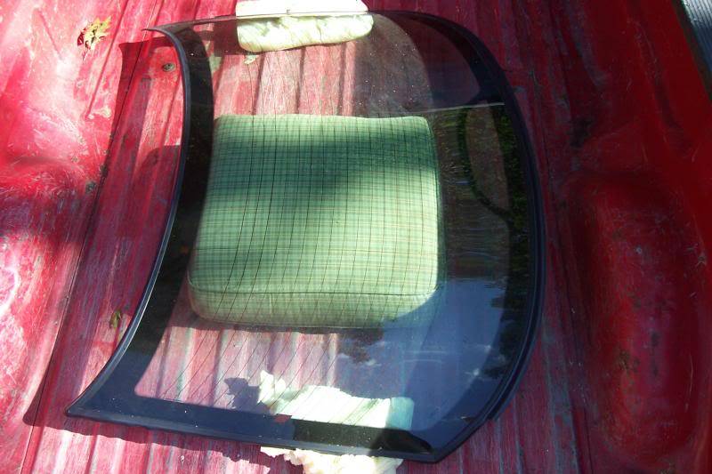

YES you can reuse the old gasket.
make sure you remove all of the old glass and urethane from the gasket. you could carefully cut off the bottom channel that slides on the inside of the glass, lightly tack it to the glass with some weatherstrip adheasive, then bed it in the windshield urethane, let the urethane ooze around both sides of the weatherstrip and you should be good to go.
most glass companies can do this without problems so it would probably be in your best interest to have a pro do the job.

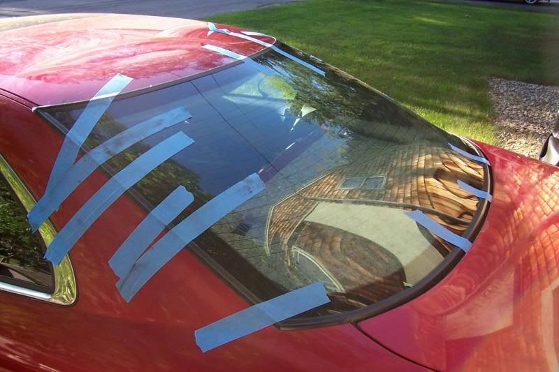

Wow finally. 75 dollars out of the car already. The gasket is better then one in Ice car! Thanks to Bruce (Dble88?)
8 dollars for tube of urethane, back in in 15 minutes.

Yep cool to show link too,then peeps can read about it. For 8 bucks its a no brainer. One tube just did rear window with like couple inches to spare.
