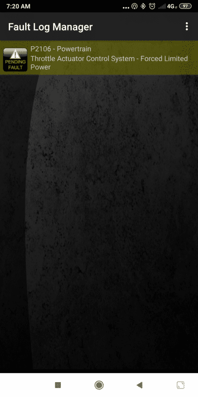

Only sensor readouts I got was 02 Bank 1 (Sept - Dec), And 02 Bank 2. I think it once threw bank 1 of the 02 sensors, but that was too long ago to remember, it was before I changed out the Delphi coils.
For now, all I am getting is Cyl 6 misfire, and ETC Failsafe.
These are the codes that show: P0306, P0316 (generic code for startup misfire), P2106.
