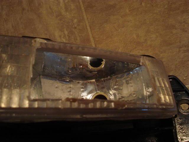

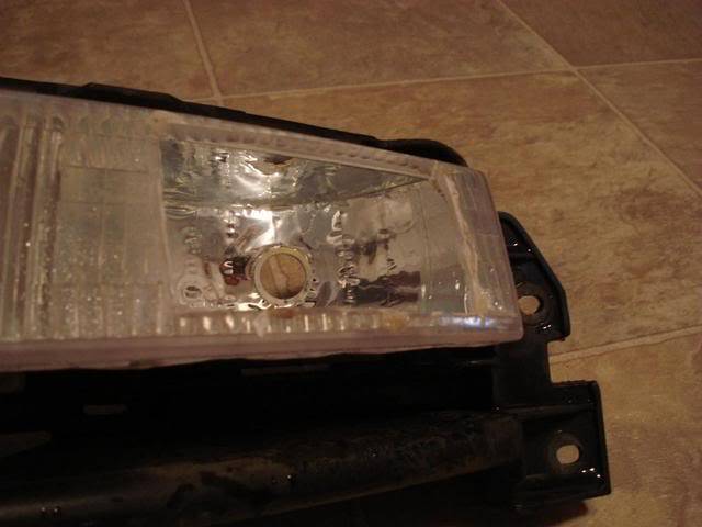

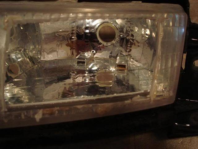

Ok, as it's been over a year running the 35w HID's, I decided to check out the durability of the chrome I'd done:
As you can see, all good!
Two things though:
1. The chrome I'd placed on the metal diffusers burnt up, so I won't chrome those again for myself or anyone else.
2. My left headlight lens had a layer of white on it's inside. (Jamie knows what I'm on about, as he gave me a good lens to substitute). Anyway, when I opened up the housing, I found there to be a white, chalk like dust on everything. Only conclusion I can draw, is that the adhesive of the chrome tape evaporated inside the housing and formed a residue - no biggy - cleaned right out.
So yeah, so far, so good! :)
EDIT: Maybe that white powder is from the chrome that burned up on the metal diffusers? Dunno, but no big deal.

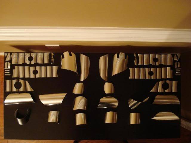

I've spent the last few weeks making and perfecting a chrome set for the gen 1 halogen DIY'er. This is the kit that's on it's way to you, Green. My apologies to others that have been waiting - I had no idea how much work was going to be involved in making this 72 piece set from scratch! More kits are in the pipeline!
Anyway, take a look at the fruits of my labour! :)
Thanks - took me a ridiculous amount of time to get right! Lol.
yeah, but now they are already patterned out so mass production should be a breeze.
Well, I have new templates made, but it's still tricky to get each piece exact. It's the sections around the bulb holes that take the longest - real hard to get just right. And that chrome :mad: - it came so tightly rolled, that working with it was a real pita. Anyway, I'll get more and see how I go. Practice makes perfect! :D
