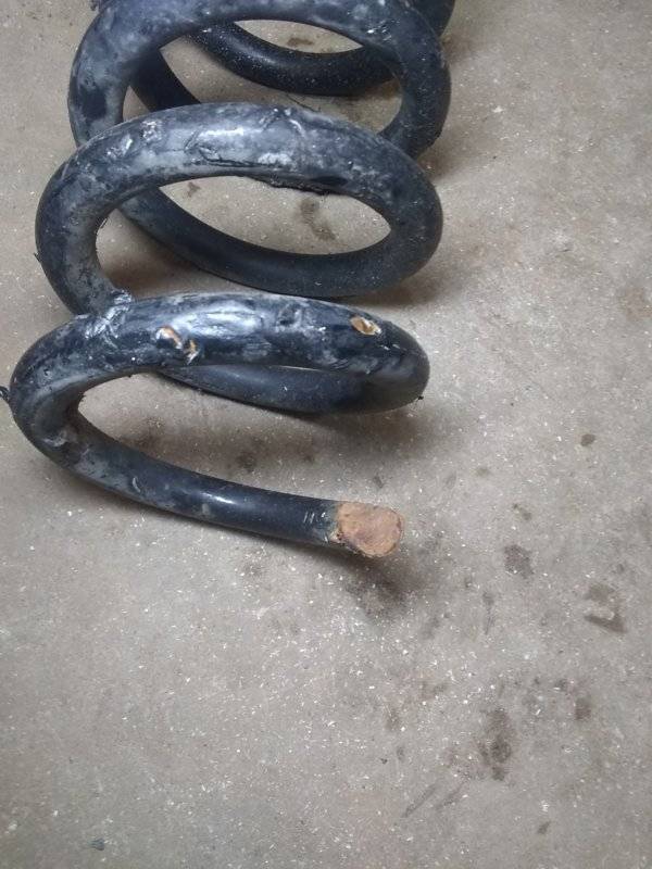

I pulled this off my LS... And this is what started me on my suspension rebuild. When I went to get some NLA parts from a boneyard... I found another spring with a cracked tail.
Absolutely agree 100% 04’ I have seen many Lincoln LS’s with springs cracked or cracked off at the bottom of the seat....
