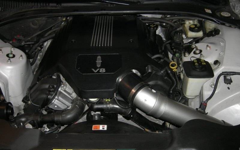

Ive been using this type of intake for a few months and had it at the track running close to a 14.1 at 99mph. Dont know HP gains, but track times prove it works.
Is that PVC tubing? Where do you have the Tubing going to? Intrested in see ing how you did this. Hows the low end pickup? sorry fo all the questions but im really liking what you have done....:)
Yes, its a thin walled PVC, so its extremely light in weight. Its only painted for looks since plain PVC looks like crap. The tubing runs down underneath the car and the cone air filter sits on the end of the piping by the front air dam. Total cost of the project was $15 including all the joints and tubing (filter was seperate, $20). The tubing fits together very snug with the elbows, so there are no seams or joints on the inside of the tubing providing a very smooth air path. The bottom end/off the line performance is great. The car loses some of the lag it has until it reaches 3000-3500 RPM's. For the cost of this project, its definately a bang for the buck.
Its not the greatest looking intake out there but it does live up to its performance. I also get a good MPG increase. I ran for 2 hours at 85mph across state at 28mpg. not too bad.

... The tubing runs down underneath the car and the cone air filter sits on the end of the piping by the front air dam...
Will you post some pics of the air filter placement. I have an idea where you put it but a pic would be great. Also did you have to cut any metal out where the pvc pipe went through the sheetmetal? What diameter is that pipe?
thanks
n8
Ill see how good of pictures I can get, Id probably have to take the wheel and fender liner out to get nice pics. The filter replacement is easy, you have to just unbolt the lower liner by the bumper to get at it from under the car. There is a little bit of metal to be bent once you look down the hole under the stock airbox, there is a piece of metal that is int he way, I had to bend it back with vice grips to get the 3.25" diameter piping down in there straight. Other than that its a breeze.

Thanks LikeNew02. Jut throwing out ome ideas since I havent seen this done on our LS's yet. This can be done very easily for the 00-02' as well.

Maybe cutting here
and rejoining the two sections with another hose piece. That way it's easy to convert to a WAI when you know it's going to raining pretty bad. Might be easier to do if the sensor were further up, but there might be enough room.
