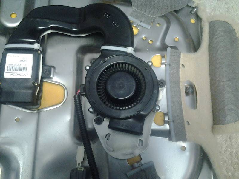

And, this is the thing on the bottom of the seat that the filter goes on. Note that the seat bottom is upside down in this picture.
Thanks for that info!! I'll look for them this weekend!!
Joegr: Thanks much for the photos and explanation, it helped a ton!! Found them while taking a break from changing out my degas bottle and was able to get both done in about 5 minutes! I actually got quite a lot done today; changed the degas, bled the system a couple of times, replaced the air, cabin and both seat filters, topped off all fluids and got everything back together. Best part is, there were NO leftover parts!! :):) Changing out the bottle myself saved me about $500, which is always good! Thanks about for taking the time and posting those pictures and explanations!! Very much appreciated!!
