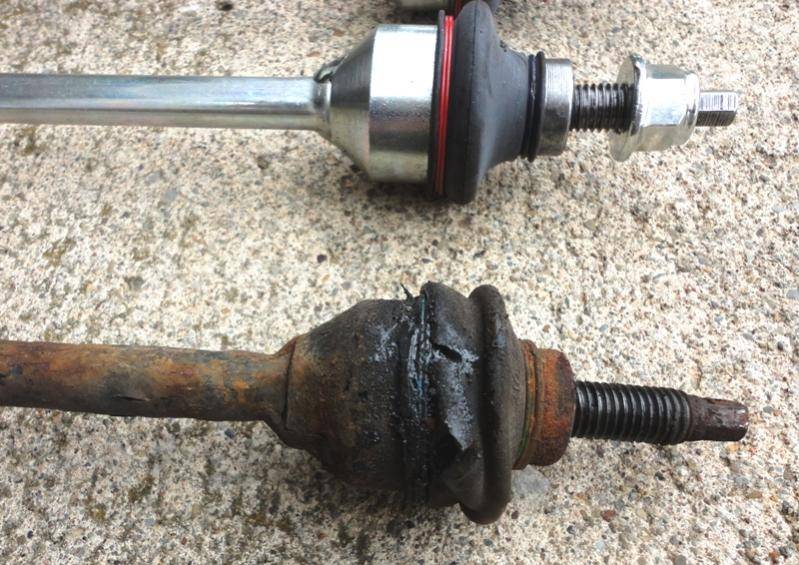

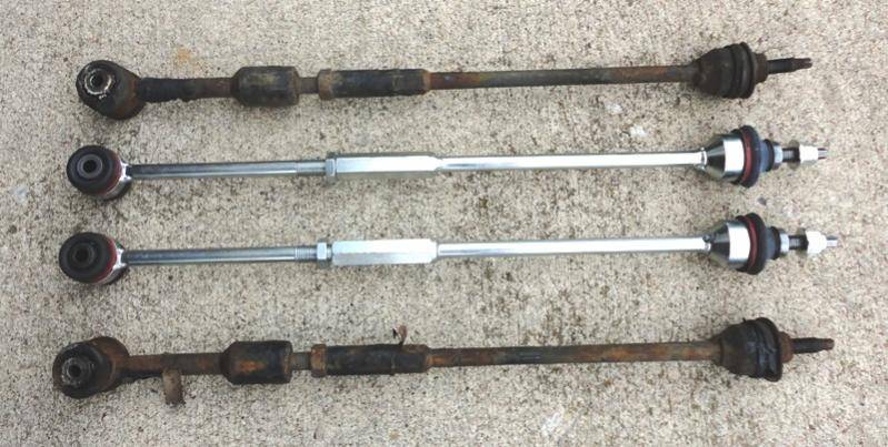

I have never really liked the passive rear steering in my ’04 LS Sport. It makes highway speed lane changes too quickly/abruptly and low speed right handed turns too tightly. So when I discovered a couple months ago that after 11 years and only 39K miles that the boots on the factory rear lateral toe control links were ripped, I order a pair of DEEZA # JA-L607 fixed length replacement units.

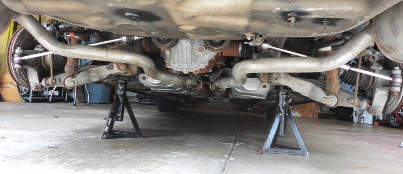

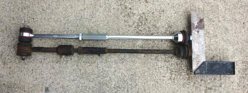

I got around to replacing these this past rainy Sunday. The replacement job was easy, straight forward and only takes about 2 hrs. I tried to match the length of the new ones to that of the old ones by setting them side to side, using the knuckle mounting bolt through both links as a fix point and adjusting the length of the new unit to match the length old one by using a short straight edge. I did this for both sides. Don’t sweet this too much, even being this anal, I must not have gotten this perfectly correct. The car is now dog legging going straight down the street with the steering wheel off by about 30 degrees. So make sure to schedule a four wheel alignment after you replace these links.

After driving the car for a few days I have to admit that I really like the handling without the passive rear steering much better than the factory setup. The rear end is very "planted" and predicable. Turn-ins are what they should be and not tighter by surprise. Highway lane changes are simple and not dramatic, without any secondary unexpected reactions or motions. A very confidant and secure feeling from the rear suspension. This is the way the car should have been delivered at the dealership.

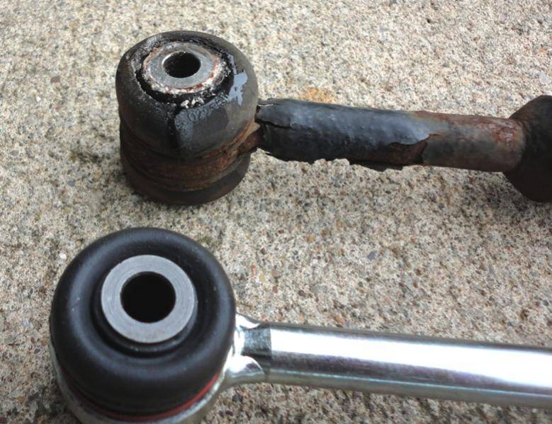

so "old worn out factory toe-links" maybe a bit of a stretch.
you have to be joking right?
look at the pictures YOU posted, those things are long over due for replacing, I don't care if the car only has 100 miles on it, its over a decade old and time can be rougher on some parts more than miles.
its not like there was one small tear in the boot, those end bushings are completely shot and the boots are destroyed! all it takes is one small hole tear (which you were completely past that point) to start letting moisture in, and once moisture starts getting in there, that when the joint itself starts getting destroyed.
it doesn't take that much wear at all for a small amount of motion outside of what the part was designed to do, to translate into major movement at the rear end with causes such poor control.

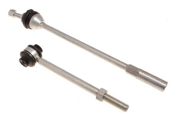

Correct, I'm actually getting non-passive for the 04 LSE and OEM Passive for the 03
EDIT - - -
Ah! I see the misunderstanding now, the two LEMFORDER's listed at RockAuto are Non-Passive toe adjust end linkages. And I do want those.
