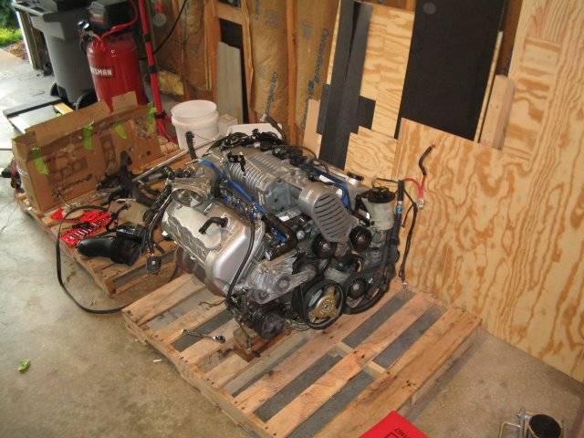

Juice is the best bang for the buck and the only way I see of your car getting into the 11's for $7000. You may very well have a Teksid block, so that is a good starting point. Any less than a Teksid, and your asking for trouble with that kind of hp. But you absolutely need forged internals...and I would go with H beam rods and the best piston I could buy. However, there are some very good crate short blocks out there too.
Another very good option would be to find an engine out of an 03/04 Cobra. Pulley the thing and hang on to your ass...it's gonna be a ride. You may have hood clearance issues with the s/c, but there are some very nice and subtle ways to fix that. You are still going to have to find a way to integrate to a computer controlled trans or go to a C4 or a stick, but since you are going to need a good tune anyway, that should be able to be handled. You could also switch to a FAST system. But even this engine can have cooling issues at the 700 hp level so a few cooling mods would need to be done...but they're not that hard. I'm guessing this would run you in the neighborhood of 10 to 12K to go this route with a good used Cobra engine, so that's over your budget...but should be reliable since it's mostly factory stuff.

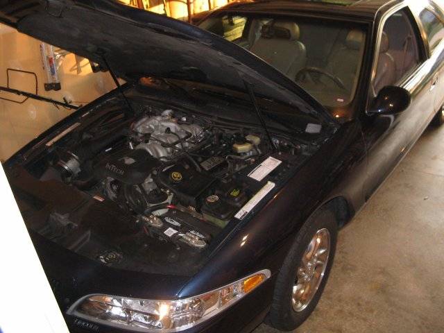

phreakness said:
Yea RIGHT! It will cost you another 5k just to put it in and get it running. trust me I know..
You and I are doing ABOUT the same thing. :)
You seem to be a little bit ahead of me tho ;)
The cobra motor seems like the best way to go, but how do you plan on dealing with the transmission? The Cobras never came with an automatic, AFAIK. I would imagine the stock Mark computer would not know what do do with forced induction, etc. Unless there is a way to reprogam it...?
