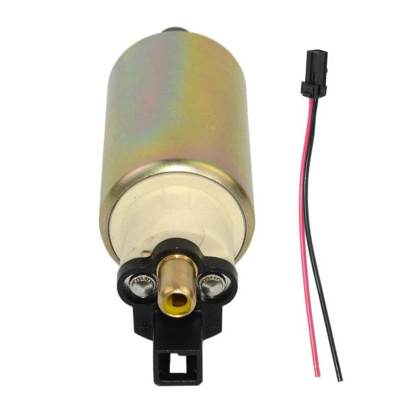

it’s way cheaper to swap the pump motor
all you need to do is make sure it has the ford style connector

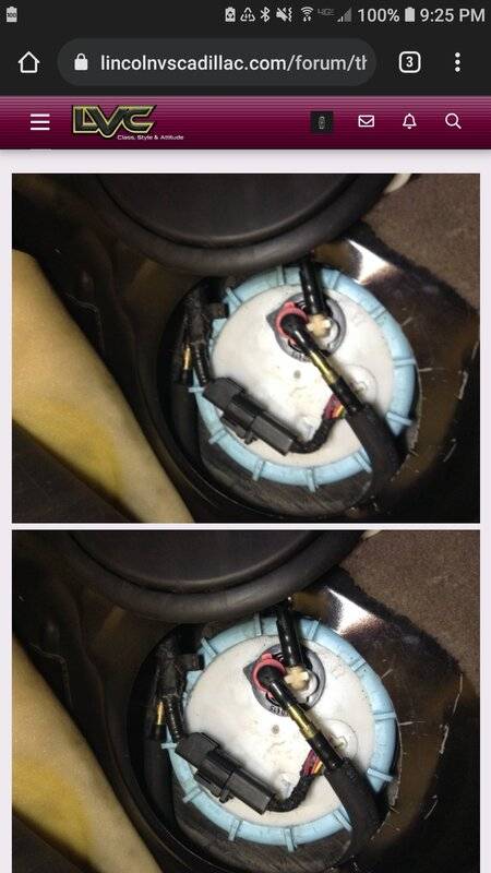

Original connections on Motorcraft fuel pump assembly broke coming out of the top of the module ...I'm saying the whole design that Lincoln/jaguar created was crap
Yep......so what did you end up doing about the connectors?
I went to a salvage yard and grabbed different connectors off a different LS then I did the same thing you did and fixed new fuel line with the OEM connectors that I was able to get off the salvaged LS with the special tool I bought a Spectra Aftermarket fuel pump assembly module because for the price of the pump I could buy the entire assembly ...I reconnected the connectors and problem as solved
