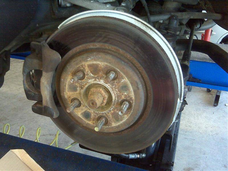

IMHO this is definitive proof that he did install said diff and he did explode said diff acting like a t0olbag.
ya'll give him a break, i believe him
it doesnt take a rocket scientist nor forensic investigator to determine that THIS axle nut has NEVER been removed..
Well you can get the diff out without pulling the axle out of the hub. Much easier to remove the whole upper arm and disconnect the bottom knuckle and leave the whole thing together, don't have to touch the axle nut or wreck the upper ball joint this way. Only have to pull one side too.
Just saying.
Yep you got it those pix were taken a few weaks before the trac loc failed, it was due to oil and it was bearing damage not actual gear failure
pix when I get back to SFL and load them from my picture
In your case, your gen 2 needs gen1 axles to do the swap.
you still can get those axle bolts off, mine looked like that when i had my rear end changed the guy said they zipped right off with an impact, he also said the exposed threads were so corroded that the nut just slid right off the rest of the way
