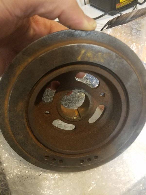

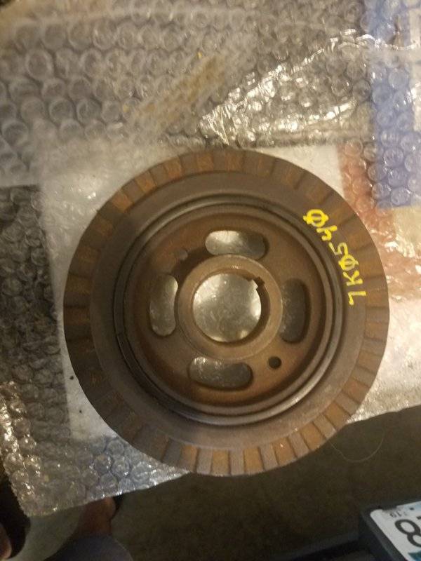

That's a good question ....I replaced the tensioner after replacing the belt ....it was an OEM Belt Tensioner and the belt is Gates or Continental ...anyway after replacing the belt the original tensioner was slapping so I replaced the Tensioner and it still slapped...long story short I did properly torque the New tensioner but now you have me wondering if I should replace the Belt with an OEM or maybe the MotorCraft belt tensioner is faulty...just seems strange that the Harmonic Balancer is wobbly or not spinning as straight as it should be or at least it doesn't look as straight as it should be...wish I was more Tech suavey I would video tape it so you could tell me what you think ...
Well I dont think I have everything I need on this part now that you're talking about rubber I dont see any rubber?
Look at the face of the balancer. There's a rubber ring sandwiched in the middle. It looks good from the pic... but look for any cracks.
Also... make sure both halves are true, with no lateral runout, (wobble). If you have a way to chuck it in a lathe at work... spin it and see. If the outer half wobbles worse than the original... it's probably no good.
Your belt and tensioner are probably fine then. Since you see visual wobble in the original damper, its probably the culprit. Just check the replacement before install, to make sure its not worse that the original.
Again... from the pic... the rubber looks good on the replacement.
Again... if you have a lathe at work... you could chuck both up and compare them. Make sure you mark them both so you don't get them confused with each other.
" Chuck it in a lathe" Okay that sounds easy enough..great idea! and yeah now that you said that I was wondering if that was the rubber ring you were talking about ..its just hardened rubber now that i feel it...and yes it does look good from what I can see...no cracks
