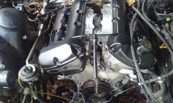

2001 Lincoln Ls 3.0 DOHC V6
Cyl 1 COMPRESSION IS 140 Psi
Cyl 2 Compression is 195 PSI
Cyl 3 Compression is 230
Cyl 4 Compression is 230
Cyl 5 Compression is 225
Cyl 6 Compression is 235
The exterior and interior are great. has 220k miles. Currently not running as he stated it was a project car.

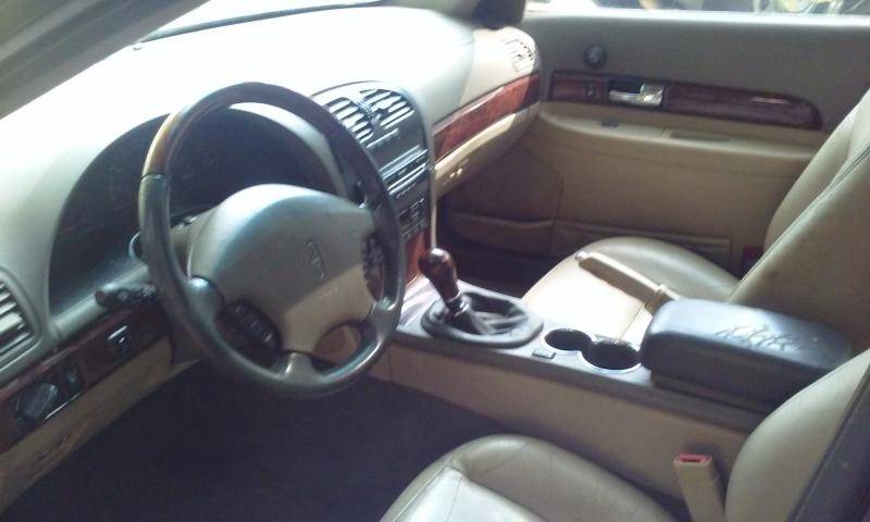

Air Bag does not match the Steering Wheel. Which one was replaced I wonder?

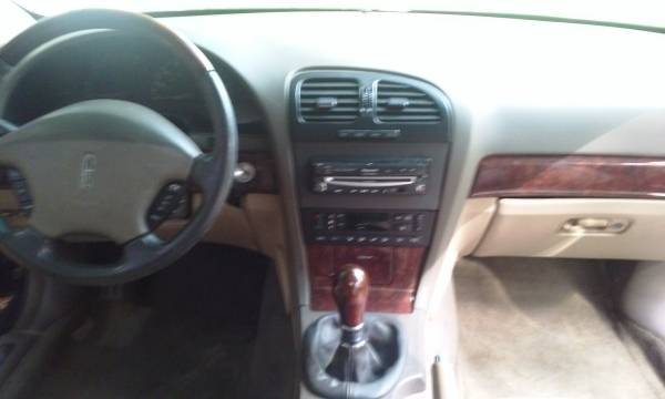

As for buying it to make a daily driver, that's up to you but on a side note, it's worth the $650 in parts. Did the manual V6 have the Message Center or am I missing something here?
No V6 ever had the message center. AFAIK, you can't make it work on the V6. He may have just added the dash piece with the buttons and not swapped out the cluster.
While both could have been changed, I strongly suspect that the steering wheel itself was changed. I doubt that the manual V6 could be ordered with the wood steering wheel (could be wrong though).
I'll give you $40 for the Center Vents with the data buttons plus shipping, as long as they aren't cracked or missing any tabs. Then you will only be in it for $610.00.

The interior is gray, the wheel is black, the airbag is gray.

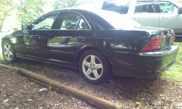

Did it come with an all-leather wheel? Also, did it come with Sport 17s from the factory but nonsport bumpers? Did the V6 manual come with some mixed up trim pieces?

1. The bumpers have chrome on them, so they are not the ones that the car came with. The most likley reason to replace the sport bumpers with less desirable bumpers would be crash damage.
not arguing with you (because I honestly dont know...) but then how would he have got the wood shift knob without the "press to shift" lever?

I'll tell you one thing, mismatched air bad cover and wrong bumpers scream one thing to me, wrecker. better really check it out if you're serious about wanting that car.

The engine bay was clean. He believes the engine was most likely rebuilt due to it's cleanliness and compression numbers on all cylinders.

...He believes the engine was most likely rebuilt due to it's cleanliness and compression numbers on all cylinders...
Those are bad compression numbers. It is too much between the lowest and the highest (well out of spec). If it was rebuilt, it was done incorrectly. I thought that you knew when you listed those that it meant the engine would have to be rebuilt or replaced.
