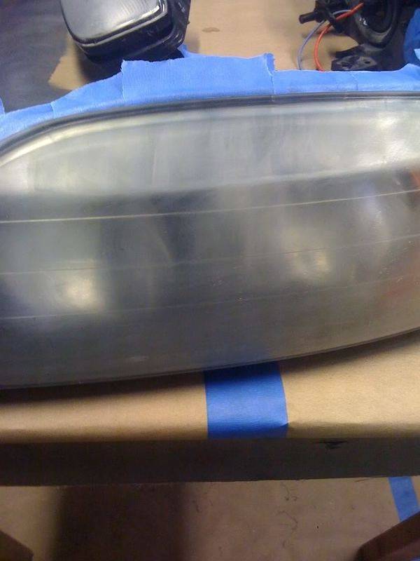

I am that guy!! Clear coated mine about 4 years ago and again recently with great results. I had to recoat because of road damage (I drive 20K/year). I have not had any problems with the clear coat being affected by heat. None at all. You have to sand the crap out of the lights, I cant remember what grit I finished on, but when you are done sanding the lights will look very foggy and scratched (DO NOT POLISH!!). The scuffed crappy looking plastic will look great because the clear coat fills the scratches in. If you try to clear the lenses after sanding smooth and polishing the clear will not have anything to hang on to. It will fall off..... I used NAPA medium clear coat, not spray can but actual gun paint clear. I dont know if the can stuff works the same, but maybe that is the stuff that peels off from heat.
Above is after sanding but before clearing.

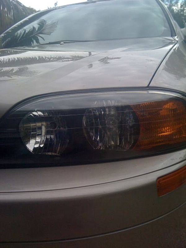

Again no problems with heat from the light damaging the clear coat. Fogs are done too and no problems. The clear coat has also never yellowed. I live in Key West FL, so the sun is at its worst down here and plastic headlight housings look crappy on 3 year old cars. This is my origonal headlight the car was in Texas origonally and I have had it since 2005 down here.
