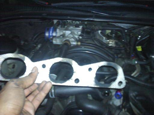

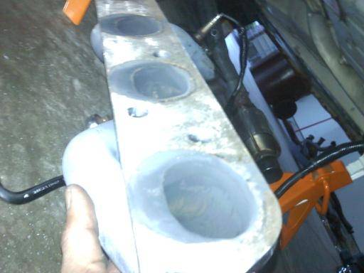

Sorry I've been gone so long. I have been really busy with the whole going back to school thing. No videos yet, but I did fix the leak. I will try to get a video up soon.
Am I reading those pictures right, you had a blow-out on 3 of 4 cylinders?
Cause if so, Damn. Something is warped.
It almost looks like the back bolt got too much love early on and it didn't let the rest of the flange seat properly. The blowout gets bigger the further away you get from the rear cylinder. Time to break out a straightedge and some feeler gauges.
Something ain't right in those pictures. It looks like the header ports aren't matching up with the ports on the head. If so this is your problem and you're not going to see the performance gain you want, if fact you might loos performance. Either that or the gasket was installed wrong, maybe wrong side, upside down, head side to header side wrong. Something is definitely wrong.
It was definitely my fault. The gasket was upside down. It's a terrible idea to work on a car at 12am. Now at least it doesn't sound like a Harley Davidson. :rolleyes:
