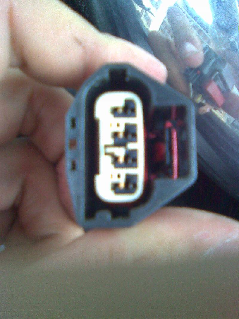

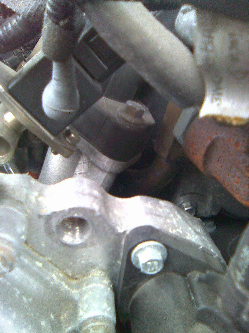

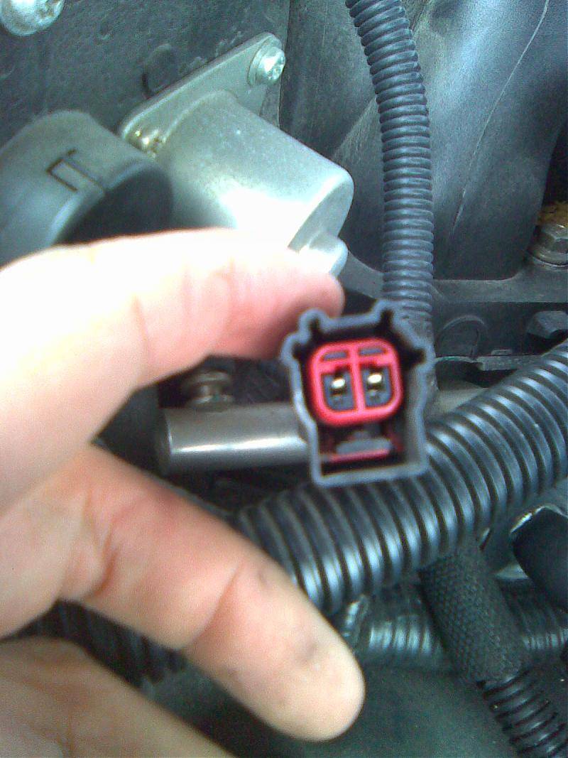

Alright just checked the connectors on my 05' 3.9 and they are a go with the 05' Mustang GT throttle body.. Pics to prove it will be attached.. Also I have another question about the Gen2 intake manifold, while I was snooping around trying to figure out what stuff was I realized that there is an aluminum runner at the end of the composite intake manifold that has the injector bungs, its maybe 2in long I got a pic of that too. What does this mean or have to do with this forum, quite possibly gonna be a lot easier to fab up a sheetmetal intake or something along those lines to go with the twinblade throttle body, that or my supercharger manifold.. Who knows.. Anywho so far this discussion is going great and Im really glad yall have had some input on this thread, I really didnt want to expeirement on my DD.. lol
