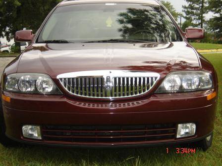

'Preciate the help everyone. Here is the finished product. Now I have to get those clear side markers...
Very nice! The clear side marker lenses would make it look even better!
