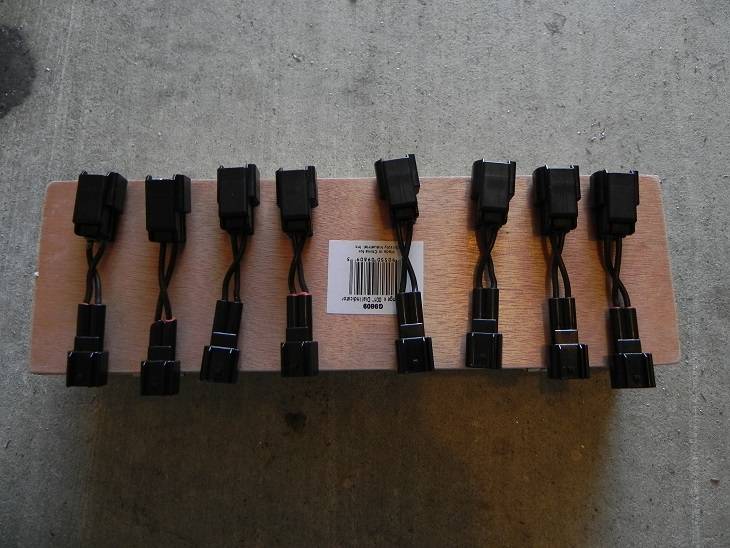

What are the mounting brackets for? If you are talking about using them to secure the coils, I didn't use anything to hold down my coils. The boots hold them in place just fine. My CEL has not come on any since I switched to these Accels.
You could also just make little extensions that are reversed themselves in case you later want to go oem, you can just take these off.

True. Since the connectors break when trying reverse them, I was going to just cut the wires, flip them, and soldier them. It seems like it would be a pain to do it on it so I just soldiered the little connectors that I bought. Plug n play

The 2 pin connectors. The first 2 on the page are both 2 pin female connectors. I accidentally got a set of each instead of one set of male and one set of female. The male 2 pin connectors are down at the bottom. The top two female connectors are identical, but one uses a green seal and one uses a red seal. One is like an oem version and one is a weaponX version, but they both plug in, they are identical. For the male connectors, it was easy because there is just one type.
Male part # CNK0009
Female # CNK0002
That's cool, though. You could work with Hite to make an Accel swap package. What was the total cost?
That would be cool, but people can just order them themselves without needing me. Hite is needed for the brackets though.
The connectors are 4.99 each, a set of 8 males= 40, plus the other end you need female connectors, another 8=40, total cost 80 for the extensions for a plug and play solution, well I guess plus shipping and the wiring.
