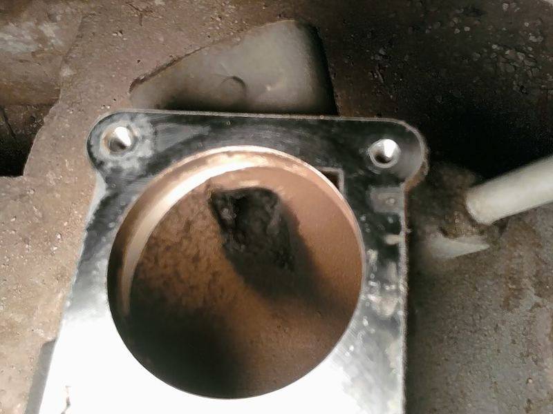

Yay for soot! =]
Egr Valve

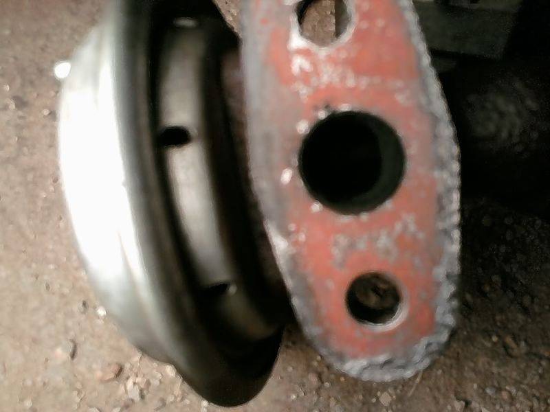

I don't know what to call this one. =/
Oh, and my EGR tube broke in half at the flexible part. Where can I get another, or do I have to make one myself?

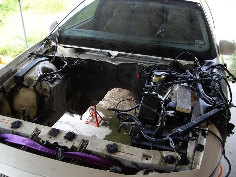

What is the routing of the strap to attach the hoist to the radiator support? Is it the upper radiator support that is used to lift the nose of the car? I am about to drop the K member.
Pull the "running end" of the strap from bumper towards engine bay, should feed under the support just to the sides of the condenser.
Position the strap as it runs across the top of the support slightly behind the hood latch.
Your straps tails should be inside the engine bay end even in length, then connect the tails to your hoist
he speaks wisdom...

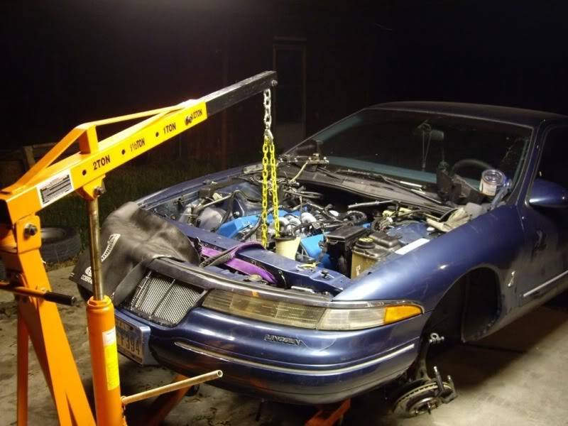

Best pics I could find just yet, hope those help, I'll dig around for the ones when we did the swap in my 93

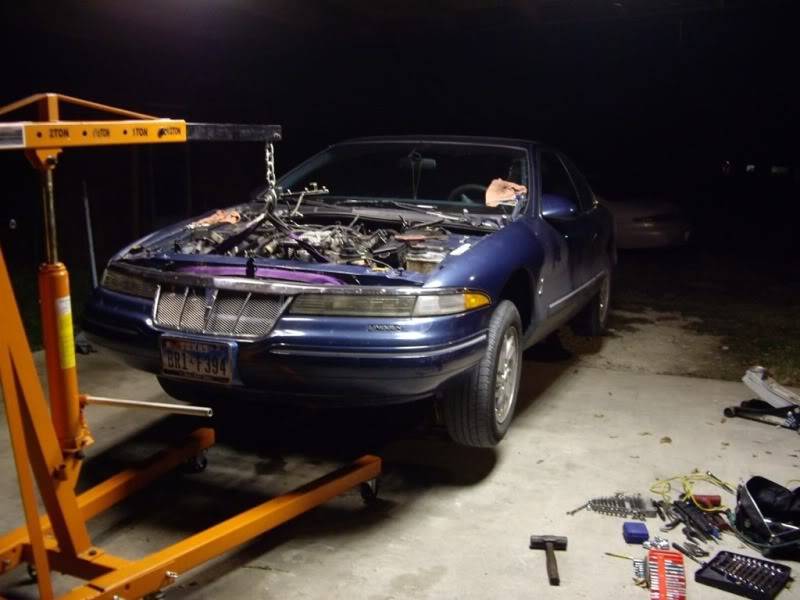

Well today was awesome! After finally getting the engine back in, and hooking everything up except the fuel tank and drive shaft, had to take it right back out!! :mad: Damn crank pulley wasn't moving at all, so I couldn't put the torque converter nuts on. Turned out to be I believe, only one stud, on the torque converter, went into one hole on the flywheel, and that was it. So, that's why it wouldn't turn I believe. I must say though, I want to thank everyone who has helped me out on here! In 3 months, I have learned alot, and removing the engine this time was a piece of cake, and so is putting it back together now. I learned not to disconnect so many hoses, sensors, etc. =p Should be up and running by the weekend. I can't wait and will try to get a video of it. Hope she fires right up! :shifty:

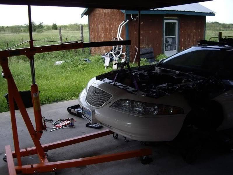

You can drop the motor out in under two hours if you are a novice. Sapperfire and I timed our last one and it took 42 minutes.
I have no idea why you are romoving intake and valve covers and EGR. Wrong wrong wrong.
