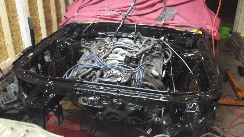

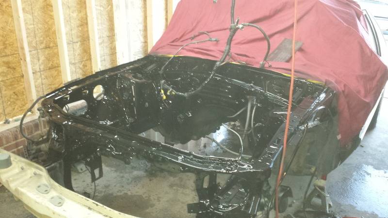

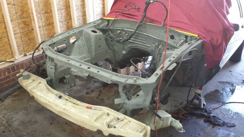

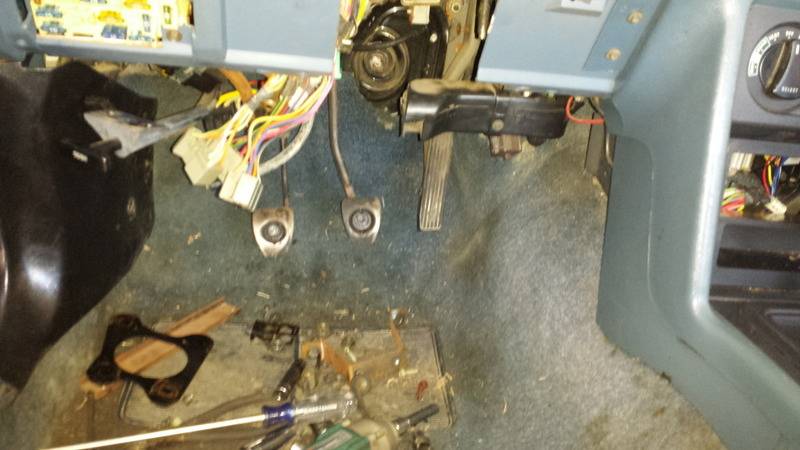

got my hydroboost fitted and my pedal assembly in

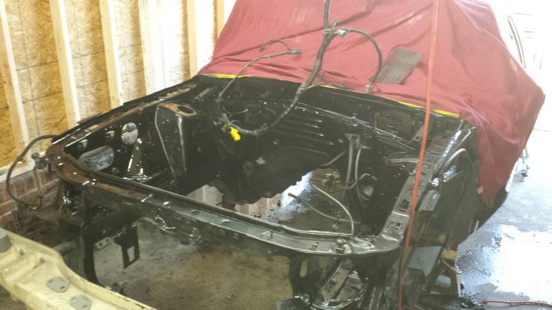

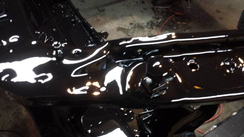

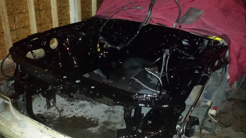

got the engine bay primed
and then painted

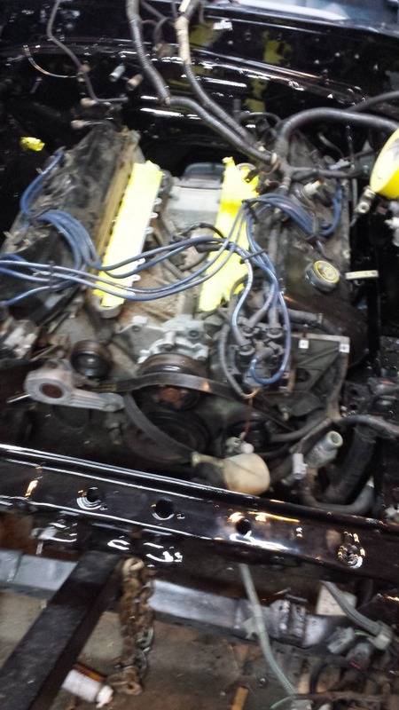

and get the engine ready to put in
ENGINE IS IN!!!!!!!!!

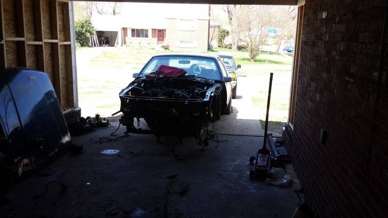

well where to start, i guess we will start where we left off last time, engine and brake system in the car with the hydro boost fitted in place and clutch pedal in the car. here is how she sat at the time.

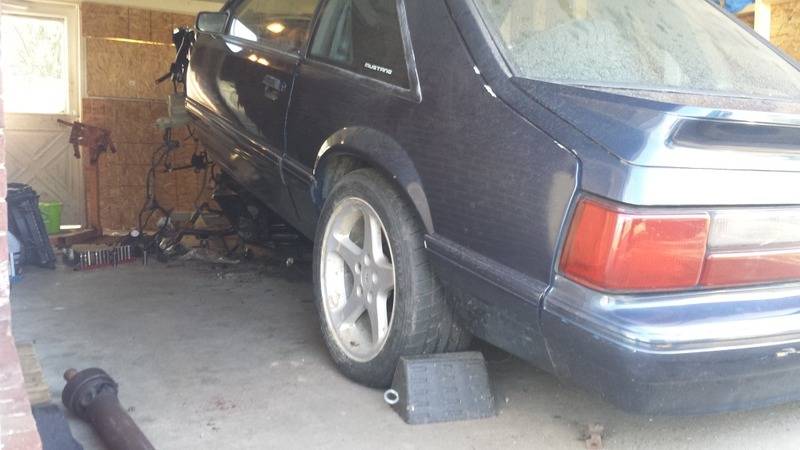

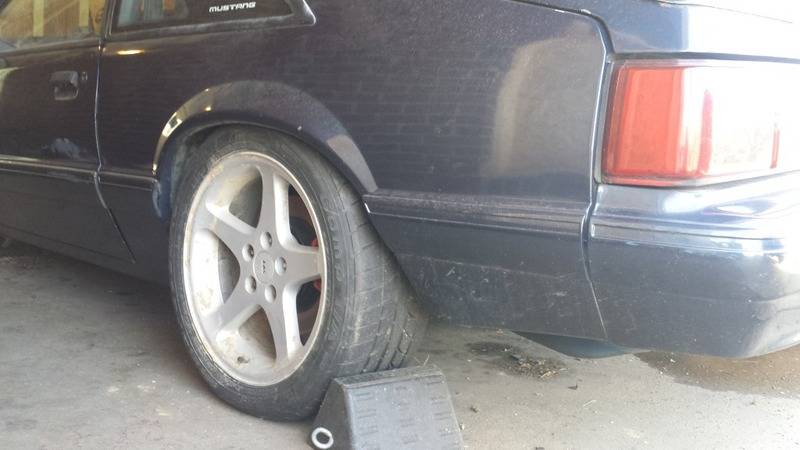

here we are messing around with the ride high, here is about where i want it.

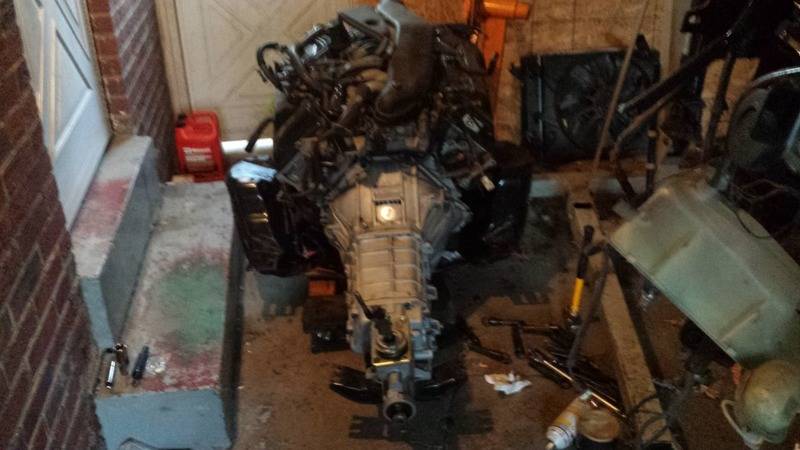

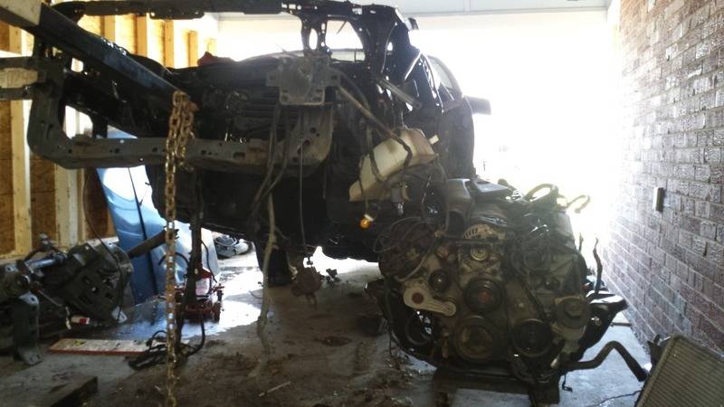

pulled the engine out of the car to get the engine back out to mate it to the flywheel and get the clutch all set up.
installed the new flywheel, pilot bearing and clutch. mated the trans to the engine,
now here is where the problems started, went to put the engine back in and ran into a couple problems. first off the intake manifold was now hitting the fire wall :Bang so i pulled the intake and then found out that the EGR tube was hitting, no big deal i wasnt going to run EGR anyways, so i pulled the egr and all components, also had to bend the heater core to block lines to get them to clear the firewall.

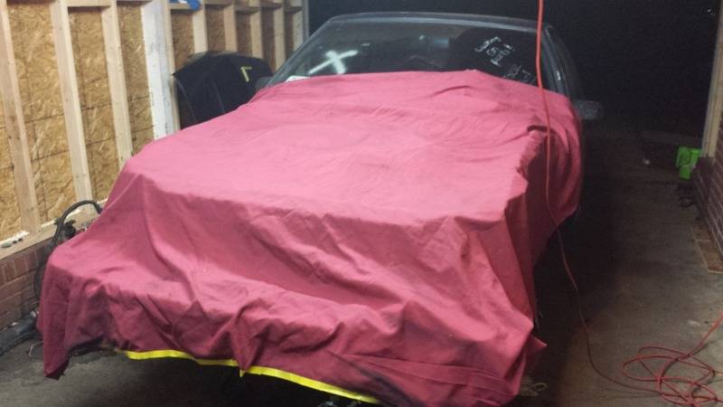

so i pushed the car out of the garage to clean it up, i had parts everywhere!!!!!!

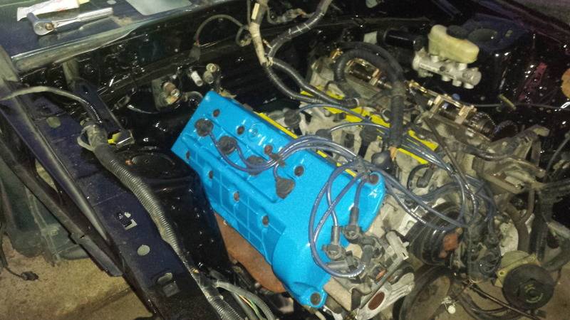

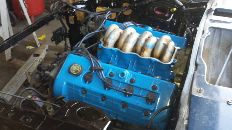

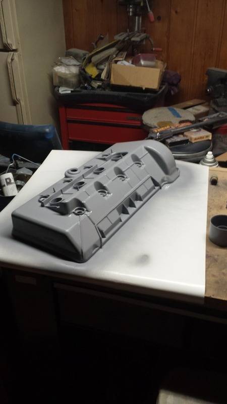

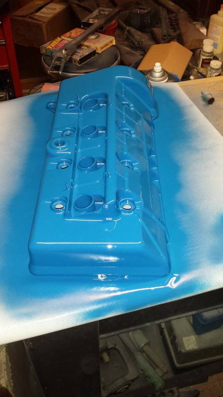

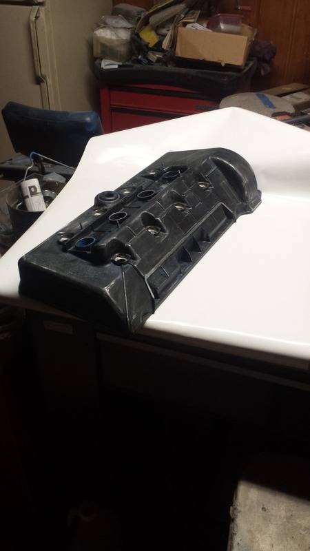

pulled the valve covers and planed to paint them!!!!
on the car, you can see how long it has been sense i have worked on her, look at the dust on the engine bay!

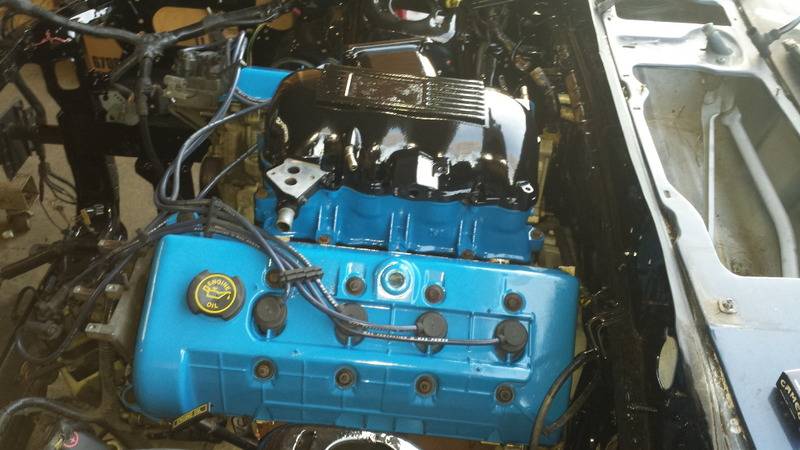

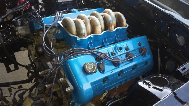

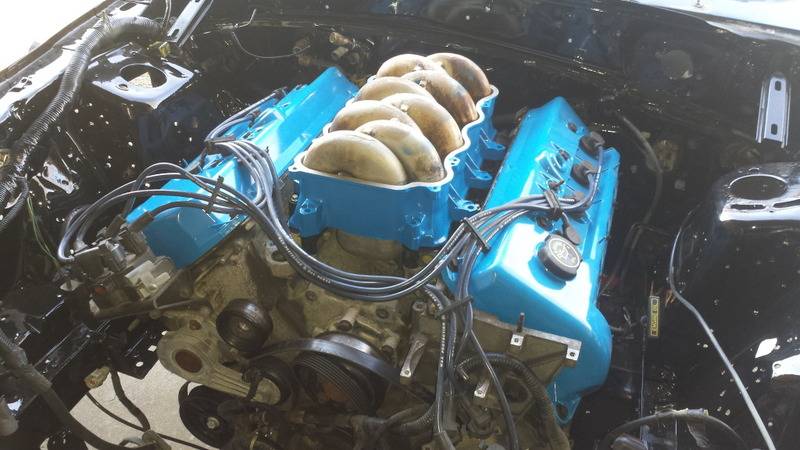

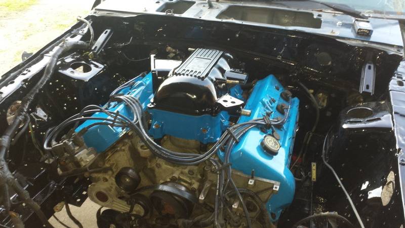

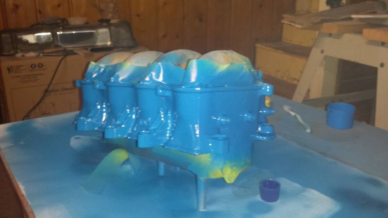

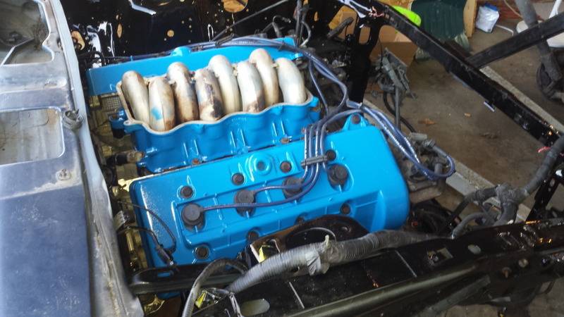

got and cobra intake and all the related parts THANKS MARKED8!!!!!!!
and painted it ford blue!!!
on the car
painted the upper intake gloss black

so here is where im at now, i need to get a trans mount and get it all wired up, also need to get injectors.
