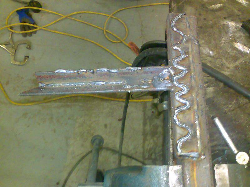

Think I could get a job with my uber welding skills? LMAO
I know, I suck at tEh welding... I have the equipment, but... maybe one day.
I appreciate the offer, GZ. But now, for the foreseable future... I won't really have a lot of time to dedicate to learning how to weld. I want to spend a couple of weeks welding, going through at least a wire spool a day. Maybe towards the end of the year I'll have the time.

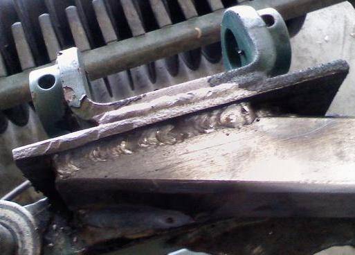

not bad, but try slowing down and weaving back and forth just a little. maybe a little more wire speed and more voltage. what kind of mig are you using? these are a few welds i put down on the handicap ramps i made for Madill air force base. just keep practicing, mig welding is one of the easiest ways to weld and fastest to learn.

The welder I was using is a Miller... 2 something? I don't remember.
Wire speed was around 30, and voltage was on 2 (or was it 3?)
I knew about the whole weave thing to make it look like a row of nickels though. Just didn't apply it. :/

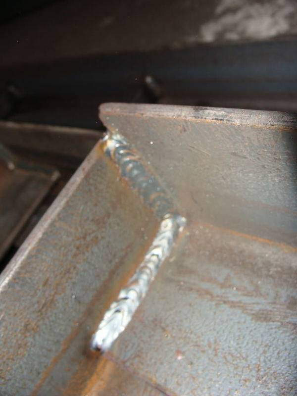

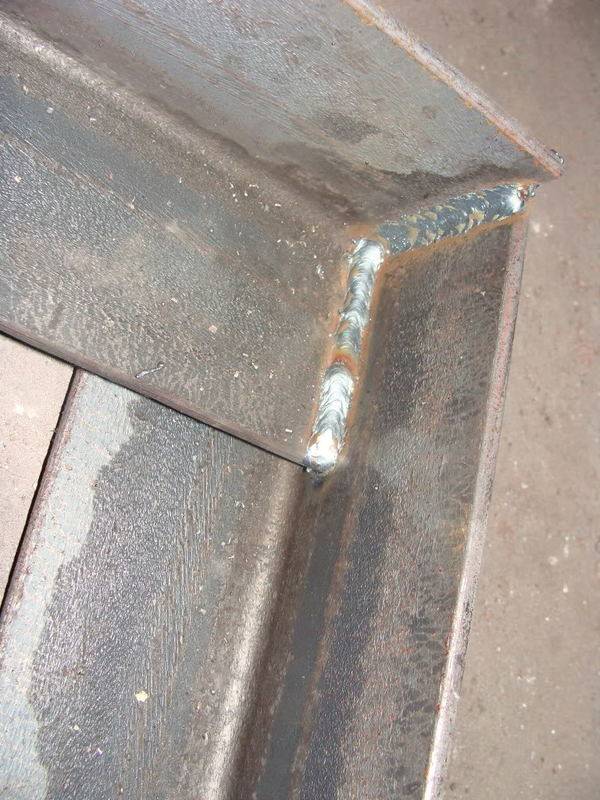

Stack o dimes, the way a proper weld should look.

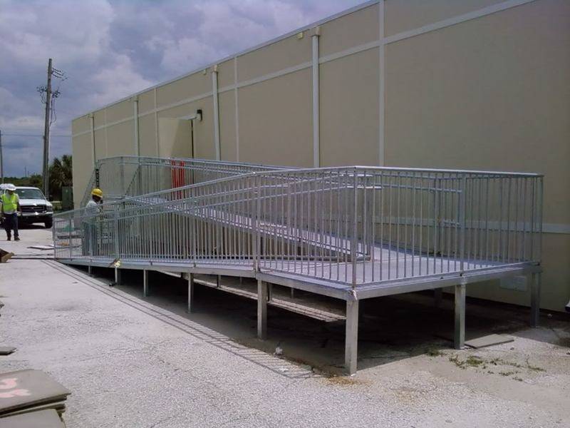

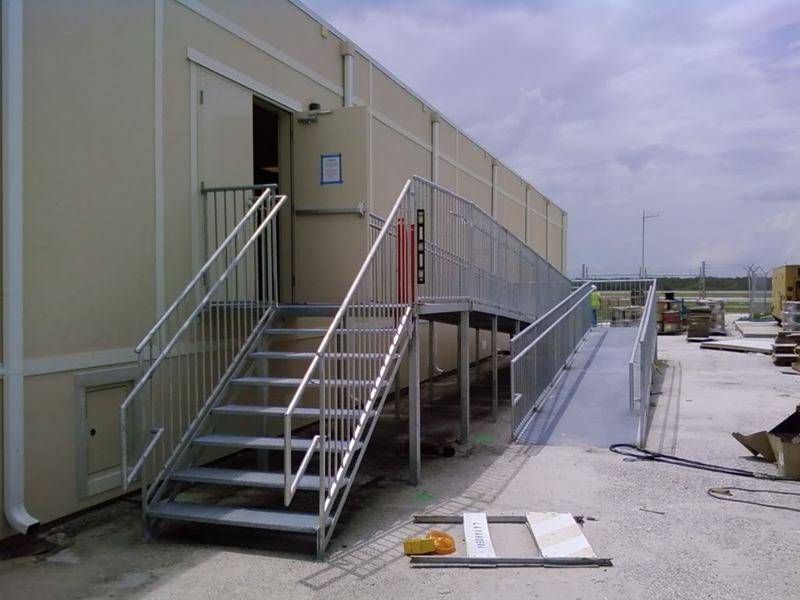

this is only part of the job i built, this was the second building we installed our stuff at, the other was about 1000 feet from this one, we are almost finished with the whole job, just have about a half a days worth of work left to do, but here it is, nothing fancy lol just some stairs and ramps, took me less time to make all this than it did to install it all.
DAMN that is an awesome picture for a phone lol, its my new LG Shine i recently picked up. first pic from it i have seen on a computer.
here is a second one.... different angle
