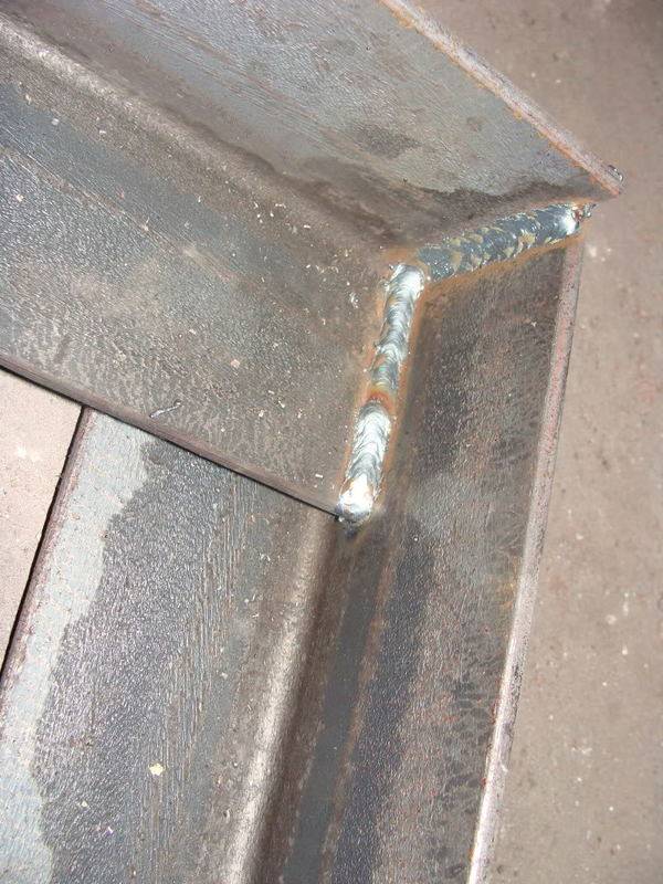

not bad, but try slowing down and weaving back and forth just a little. maybe a little more wire speed and more voltage. what kind of mig are you using? these are a few welds i put down on the handicap ramps i made for Madill air force base. just keep practicing, mig welding is one of the easiest ways to weld and fastest to learn.
very nice, wish i could say that was mine.
